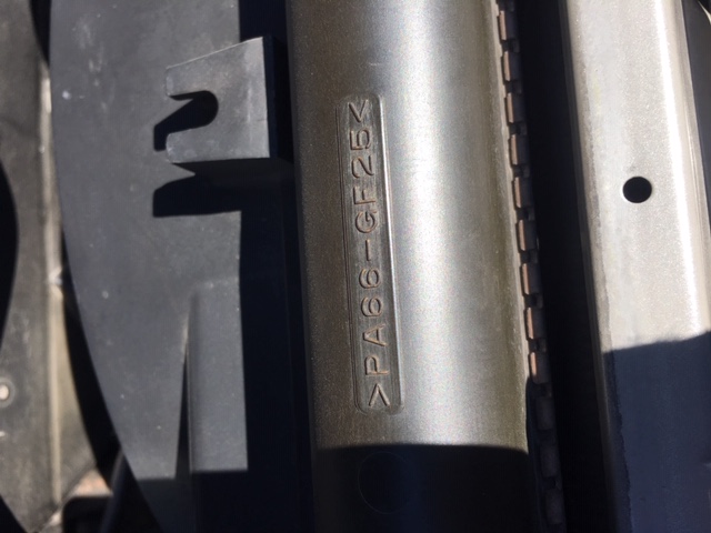

Original Stock Radiator?
Post a pic of the top tank, specifically any markings or stickers
Reviving this thread. Can anybody tell from this photo if this is an original stock radiator. It does appear to be on the olive drab side, [MENTION=92548]sakoluvr[/MENTION] especially in this pic, but that seems to be more from age than anything else

If its that color, it is probably pretty old - they all start black. The letters/numbers in that picture are a description of the plastic type used on the tank (polyamide/nylon 66, 25% glass fiber reinforced), not a part number.

Does Toyota still sell that radiator with the material break down number stamp or have they completely transitioned to the Denso Taiwan units?
