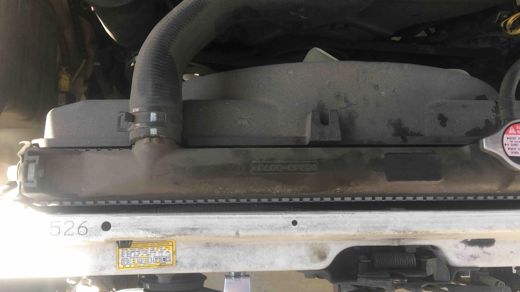

Damn you guys are good. I agree on the just replace it idea. I was thrown as I saw a Denso sticker (yellow and white) and and the cap had a different color sticker but it is olive so I suspect you are right and it is original.

Does the top of the radiator have an olive drab color to it or is it black? Original radiators have that olive color.

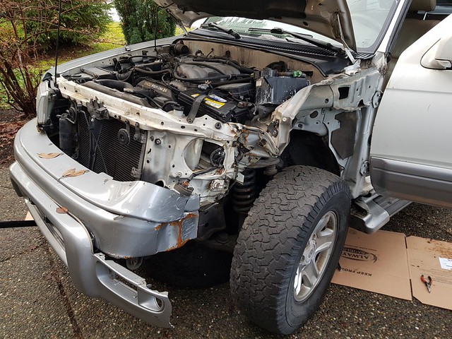

I recently picked up a wrecked but really nice 2000 automatic. Obviously the radiator should be replaced especially with the stress of the front impact possibly damaging the internals of it. I already have a Champion aluminum radiator in the box that I was going to put in my manual 4runner. But the pink milkshake isn't an issue with the manual so it's not super urgent that I swap it out since I constantly monitor temps with the Scangauge.
I am wondering if the pink milkshake is also an issue with the Champion? Should I still plan to use a separate bypass cooler with the Champion?
It's a shot in the dark. This radiator is still fairly new and not very proven. I don't hear great things about Champion in reviews for their other radiators. You'll be the guinea pig.
