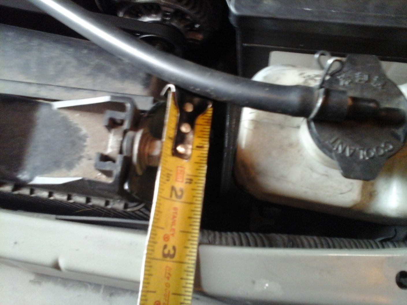

If anyone has a minute, can you check the overall thickness of your radiator and post what it is? I know earlier in the thread people were talking about thicker rads, or that the Denso had a thicker core than the Koyo, etc.
I'm curious if that impacts the overall thickness of the rad, because now that I'm getting ready to replace mine (not sure on the brand, but 95% sure it's not oem) I remembered that I'm space constrained due to my dual battery setup. Mine is right at 2" thick, not including the shroud. The core is less than that, it's 1/2" inset in the front, and I wasn't able to easily measure the back due to the shroud.
I asked one of the Toyota dealers on ebay if they could measure the 16410-AZ011 for me, and they wouldn't, they just want your VIN.
your top looks exactly like mine and its a little over 2 inches on top little more on the side and the fins thicikness is a little less then the top.
