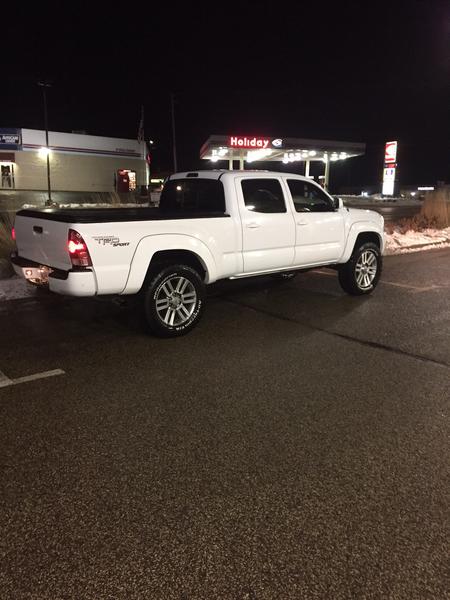

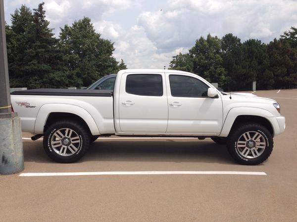

Hi all, first time post here but i am a regular on TacomaWorld.
I have a 2005 taco, but i put the 20" 4runner wheels on it, and i absolutely LOVE the look. 34" BFG TA KO Tires and the combo is great.
My question is what agressive tires do people run with these rims? I need to keep an agressive look but also want a lighter tire (34"BFs are heavy and reduce my performance and MPG). I've been leaning toward Duratracs (they have an SL load tire thats about the right size) but i've heard bad things about not being able to keep them balanced and since it's such a narrow rim i think it could be a problem.
Any advice and/or pics are appreciated....

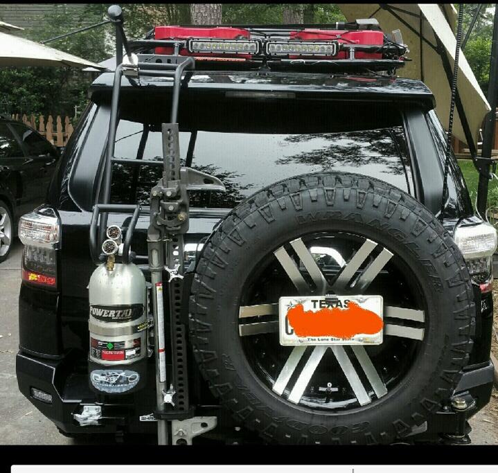

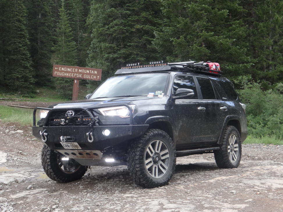

Thanks [MENTION=115953]HerT4R[/MENTION] ! I am running the DuraTracs 275/65/20s on my Unlimited.
I did have to get a BMC done in order to make them fit though. BUT I REALLY like the look

HOT DAMN that's a good lookin runner. Have you had any problems with uneven wear or balancing & shaking problems? how many miles on them? Just trying to make sure i dont end up with some bad tires... on the TacomaWorld forums some people have reported really bad experiences with Duratracs, and i feel we are more prone to these issues if we mount them on our narrow wheels

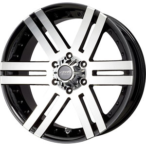

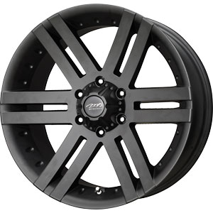

my opinion get these. they come in 17 and 20 in the correct sizes from discount tire direct that are a pretty close in design to the OEM rims.

Thanks for the props! I have about 20k miles on them and have had no issues at all. Tried Nittos and a few others before settling on these. Love the aggressive tread pattern. I FEEL like these are the best for me and my rig.

These are actually a pretty good alternative. I had Discount offer to give me a free set of these once they realized that they should not have mounted my Duratracs on my factory rims.

I like the way those rims look a lot more on your truck then on the 4runner... for what its worth.
