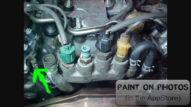

Well after 9 months I'm finally buttoning up the head job on my '95. When I started this I labeled all the hoses with duct tape and perm. marker. However after the past 9 months of sitting outside half of the tags have fell off or are not readable. Guess I should of take more time and drawn out a diagram as well.
I've gotten most of it sorted out but I have a few lines I can not figure out. The first one is coming off of the rear of the motor as pictured. It's the one all the way to the left which is the drivers side. I cannot figure out where the other end goes. I'm praying it's not under the upper plenum and now I can't get to it.

Small diameter tube goes to the partially insulated hose that runs coolant through throttle body. It goes to the inlet below and to the firewall side of the air intake.

The image I put on here is one I got from Google. The partially insulated hose is actually connected to the metal line shown. You say below the intake, so now that my intake is all bolted up nice and tight am I screwed and have to pull the upper plenum back off? That would suck.

You shouldn't have to pull the plenum. The coolant tubes comes out of the throttle body parallel to the valve cover. Facing the TB from the driver side fender the hose would connect to the tube on the right side of the throttle body. The coolant continues through the TB and in to a similar hose on the left side.
