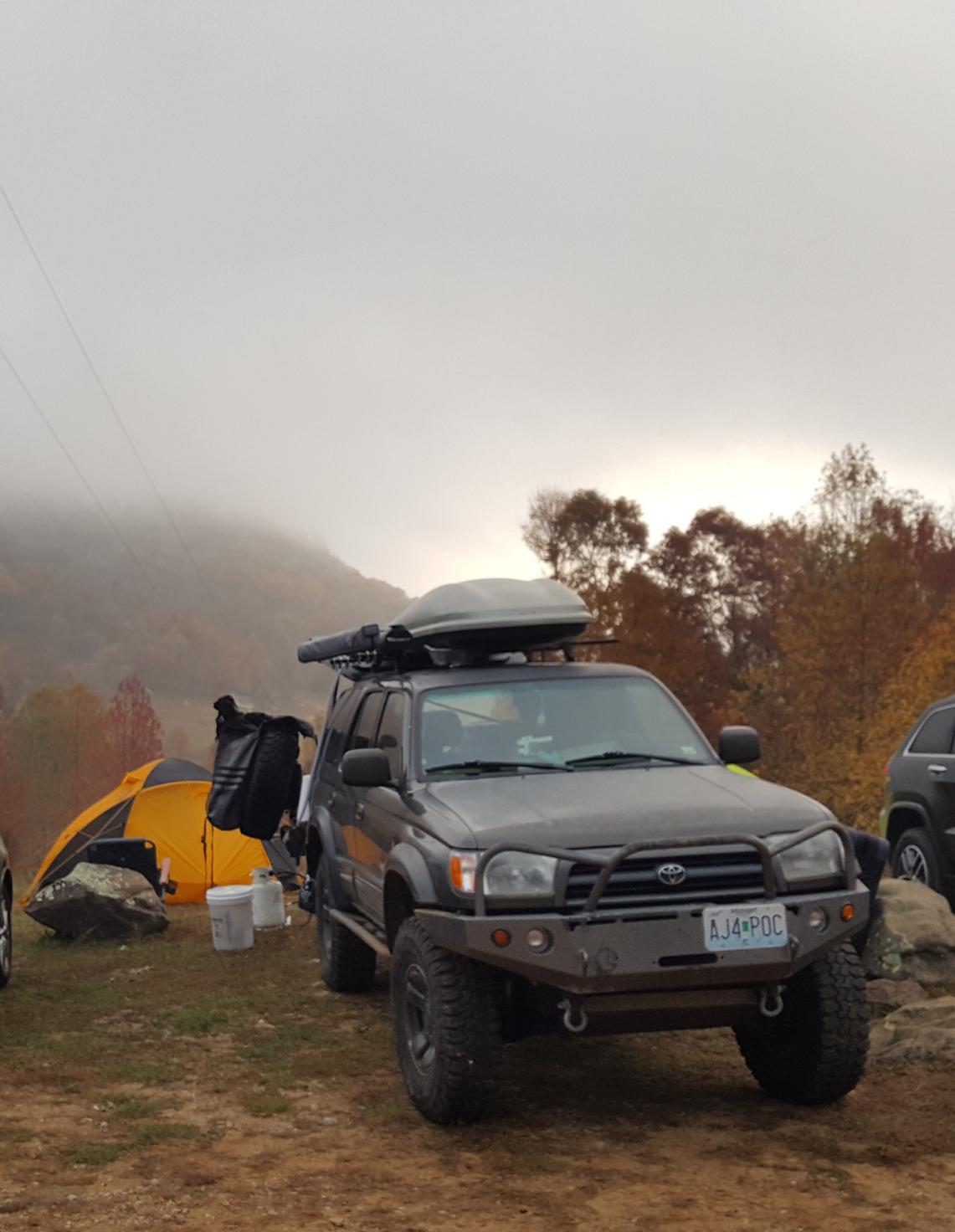

Nice resurrection thread. That being said, I have the arb 50quart from a group buy. Not buying ice is pretty nice. Here is a picture from camping at horseshoe Canyon Ranch. The arb is back there and helps turn great food into gourmet camping meals. Sorry I do not have any current picts of the arb in action on my phone.
