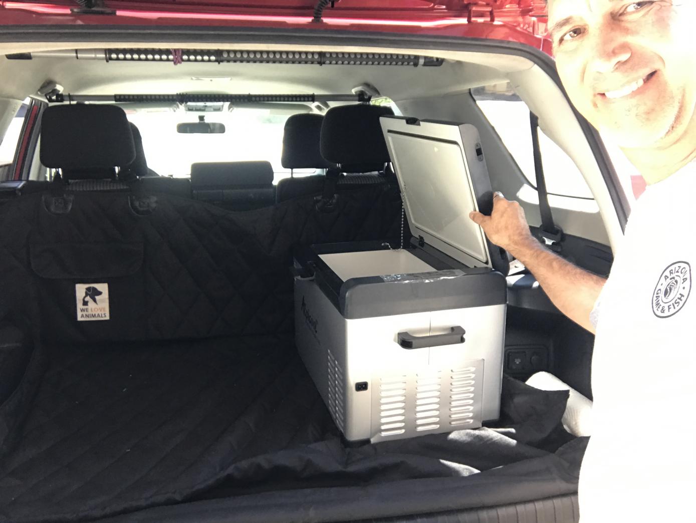

So I finally pulled the trigger. Didn’t go high end but found one with good reviews and features for the price. Alpicool C30. It’s about the perfect size at this stage for me. Testing it in OEM rear 110 outlet today after it was already chilled down and I did notice it didn’t maintain temperature. Seems the 110v outlet only runs 110w when driving. When I parked and activated 400w mode it started cooling right down. Gonna year the 12v outlet next - but will most likely run a dedicated 8ga line to the back.
