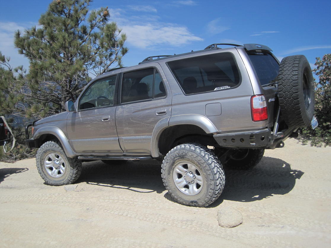

I love my toyo open country mt 255/85/16, I have about 37k miles on them. I will probably get the same tire when the time comes. The tires are E rated and I usually run 12 psi at the trails with no problems.
Awesome. That is some good mileage for those tires.
