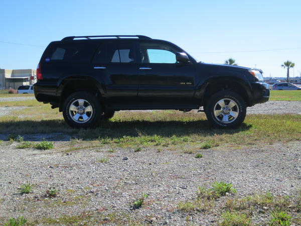

I have a set of 235/85/16 toyos that I want to run. There currently on my pickup I use to haul stuff around in but they don't get enough use so I want to transfer them over. They have really low miles on them. I just think they'll look way to skinny for my lift

255s require the same lift as 285s. Maybe a tiny bit less, but they are basically just another option for 33s with a standard 2.5-3" lift. No wheel spacers needed with the stock wheels and 255s, they are skinny.
I always ran my 255s on the trails at about 12-15 psi and I never popped a bead and I had them on my original 7" stock 3 spokes.
Hmmmm I only have a 2" body lift... I winder if a little trimming and maybe spacers if I could make them work? I want 3" suspension eventually but one thing at a time right lol.
A 2" bl will be enough for 255s. At full compression, you'll actually still be better off than a suspension lift alone as far as tire clearance goes. You might still have to do a little pounding on the firewall, but that's what everyone has to do anyways with 33s.
