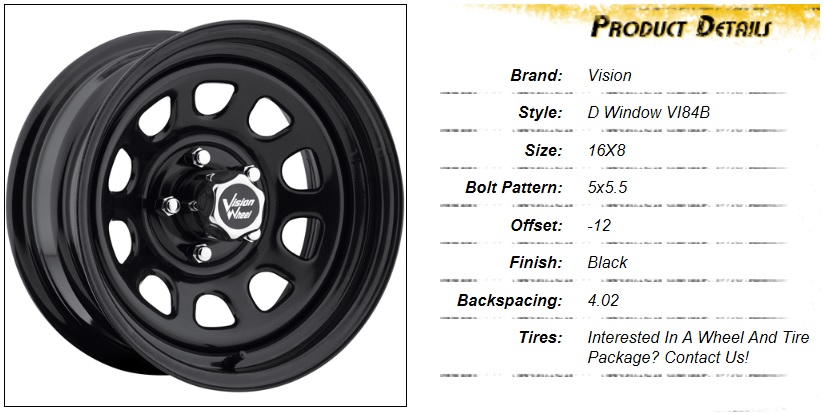

So help me understand backspacing. So the lower the number the more the rim would stick out the side of the vehicle? So the wheels in the pic I attached would work well then?​
