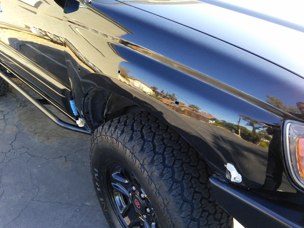

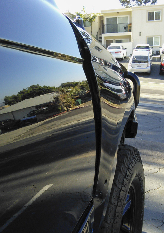

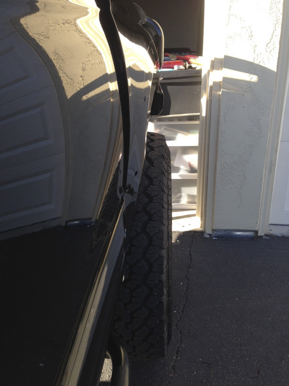

Just don't be like me ...
285x75x16 w/ 1.5" spacers, factory Toyota 5-Star 16" Wheel.
Damage report:
1. Bottomed out the front end when I hit some dirt mogals on my way out of DV. This resulted in a bent passenger fender because my 285s were sticking out toooo far. The front drivers and passenger flares completely popped off.
Bent Passenger Fender
Damage report:
