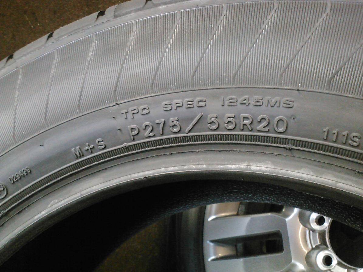

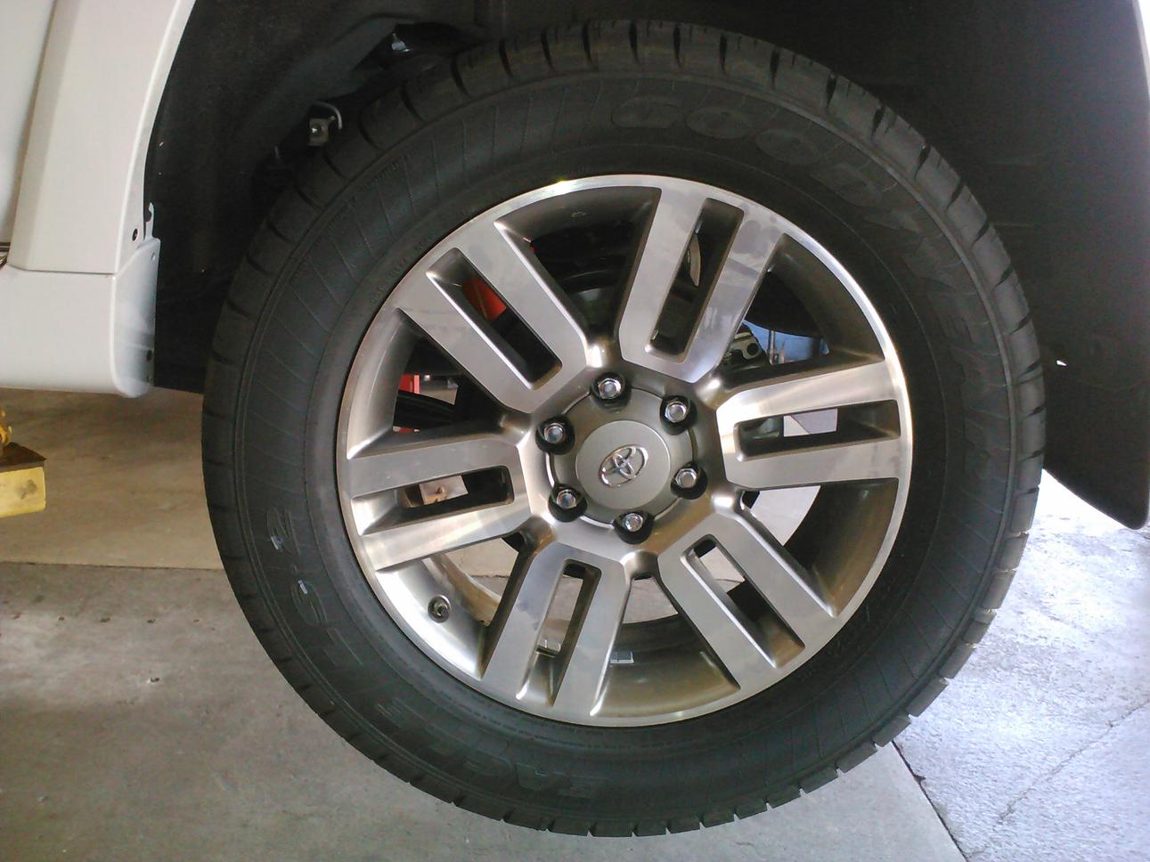

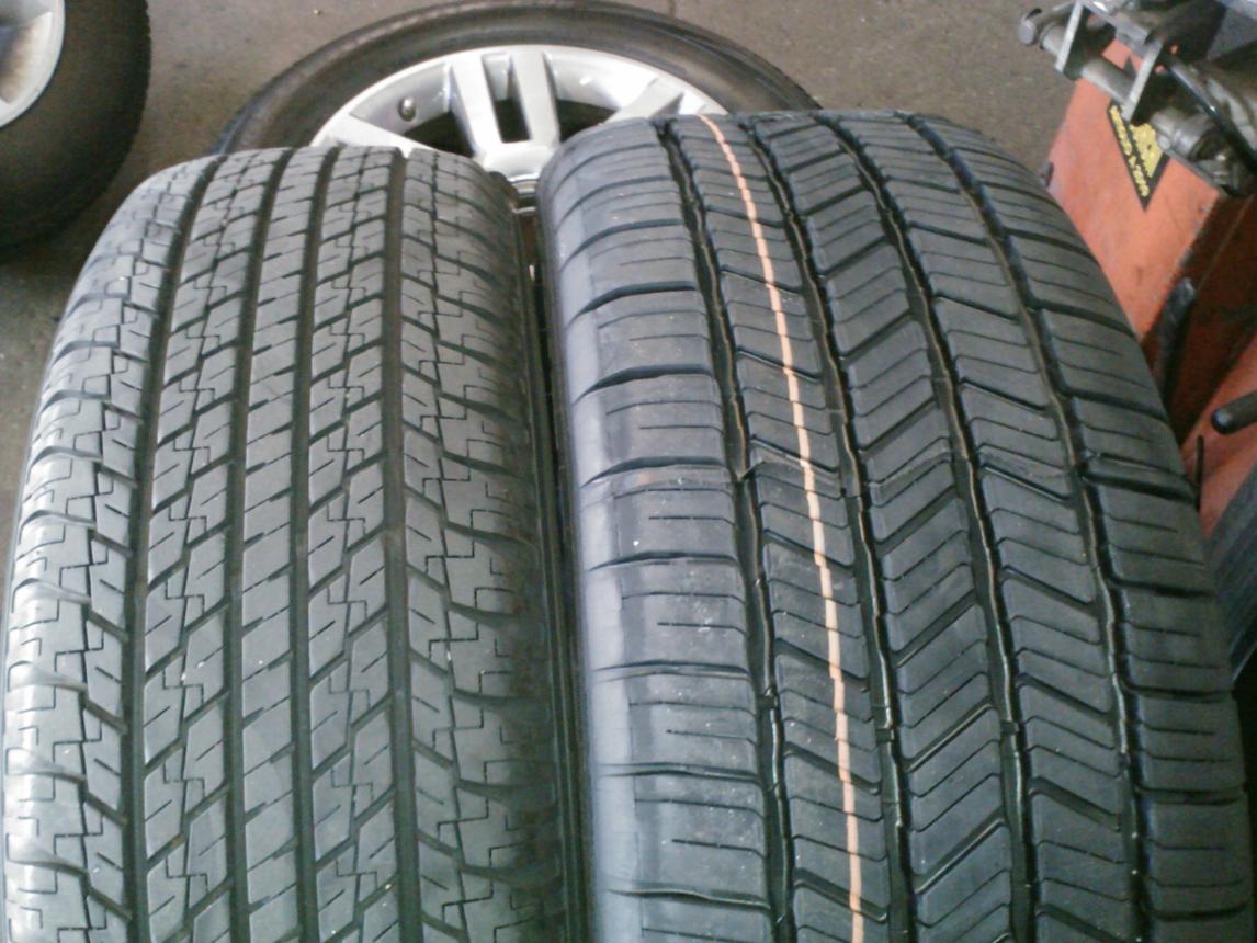

Last week, I upgraded from the O.E. Geolander G96B 245/60/20, to the Gdyr Eagle LS-2, 275/55/20. WOW!!! What a difference. Using no lift, no spacers, and stock "Limited rims", all is well.
But, I don't know just what to expect if I ever took her "off-road", rubbing, bottoming?!
Here's a couple of pics:
