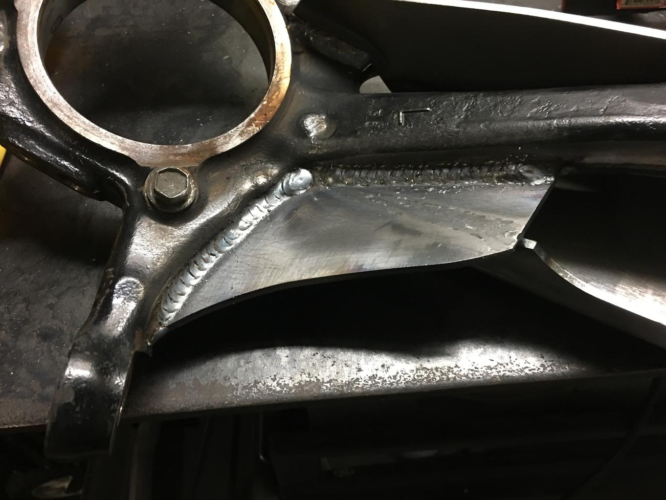

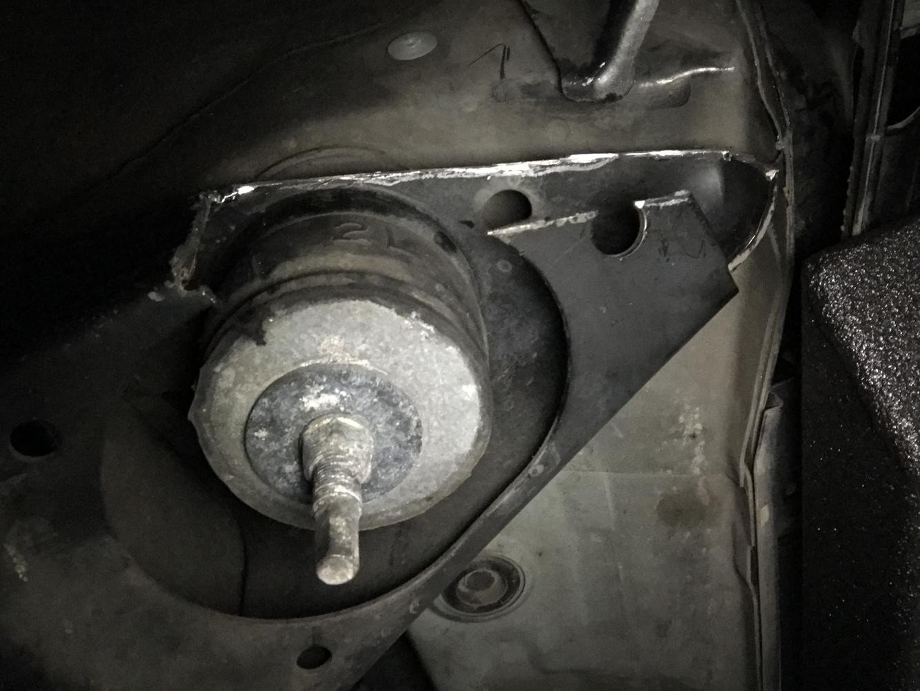

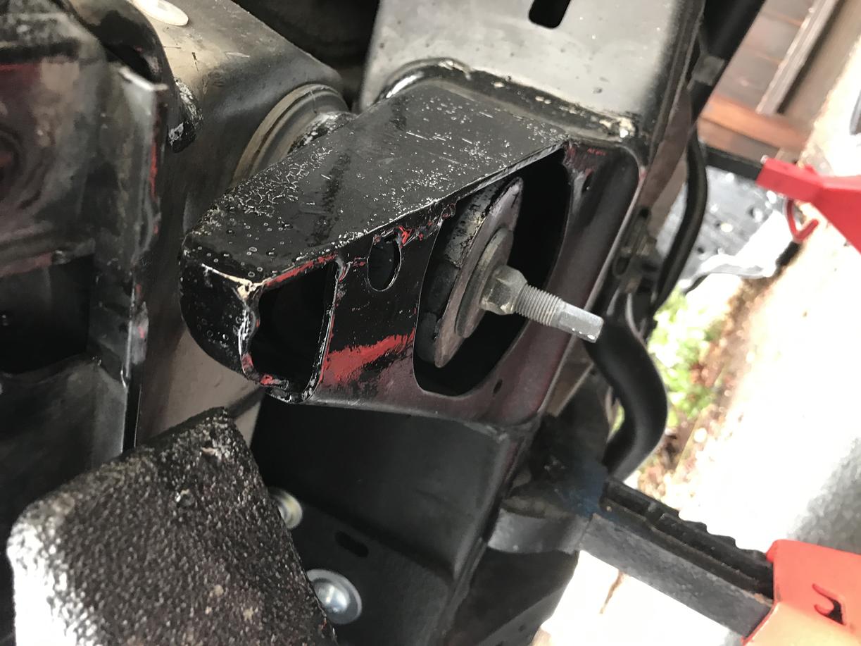

I will not be doing a bodylift! Finally, after 7 years and inspiration from Darknight's build, I'm about to start a significant build. I have 17" SCS wheels. Body mount chop, BJ UCA, front diff mount reinforced, spindle gussets and sliders just completed/installed. Full skids, suspension (extended front & LT in rear) have arrived. Also, installed 4.56 & lockers just go back from Zuk - gearinstalls.com.
