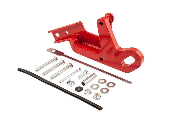

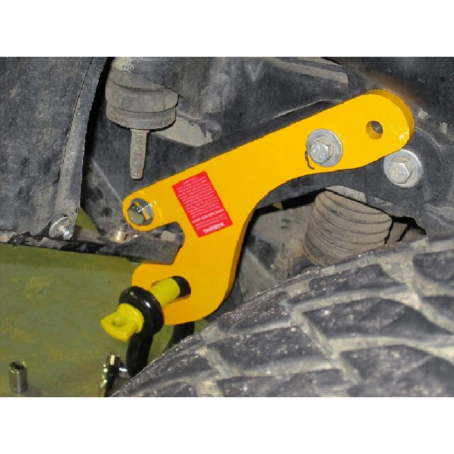

Will aftermarket recovery points for Prado150 or FJ Cruiser work on 5th Gen?

in theory it should, as nearly all the attachment points and bolt points carry over. however won't know till you try it
i like that shackle mount
id like to see you attach a snatchblock to the stock ones without a D ring

no, you can't. but the factory piece is not designed for transitioning a load through a d ring. there is a possibility you could damage the factory point

From ARB USA:
Hello,
I am unaware of them fitting the 4Runner but they might be made to fit. the 4 Runner, Prado150 and FJ Cruiser share the same platform but not sure on bumper mounting or in this case the recovery points.

I've never had an issue getting at the stock recovery points. And who does not use a D Ring. Unless your wheeling alone... its most likely going to be a strap you are connecting.... The hitch based D rings work great for pulling people out... However, I have never been buried in the mud. I avoid that crap at all costs.
If I was putting an aftermarket plate bumper on I would use those points, but I see no no need for the ones shown here.
I've been actually been denied going on a trail ride with a group as the guy running the ride didn't allow vehicles without "proper" front recovery points. He insisted that factory "tie downs" were not suitable. No amount of convincing would change his mind.
Throwing one of these on may alleviate the issue in the future.

I've pulled many people out with these and never had a problem. If you inspect you can see that the strength is better than what most bumpers provide.

Whoever denied you doesn't know what they are talking about. The loops go through a frame cross member and are welded both sides. I trust them at least as much as the 1" plate on my Shrockworks bumper, just less convenient to access.
This. The factory tow hoops are probably good for 100,000lbs. I have no idea what alloy they are, but it doesn't matter. The after market bumpers bolt into the same spots. The ultimate failure point is probably the frame material anyway. It's less than 1/8" thick. Putting a big thick tow point into thin wall frame material isn't exactly making anything stronger. Spreading loads to both sides with a full bumper helps, and it's a heck of a lot more convenient, but not necessary for strength or safety.
I can get onboard with more easily accessed points, but you won't make them any stronger.
