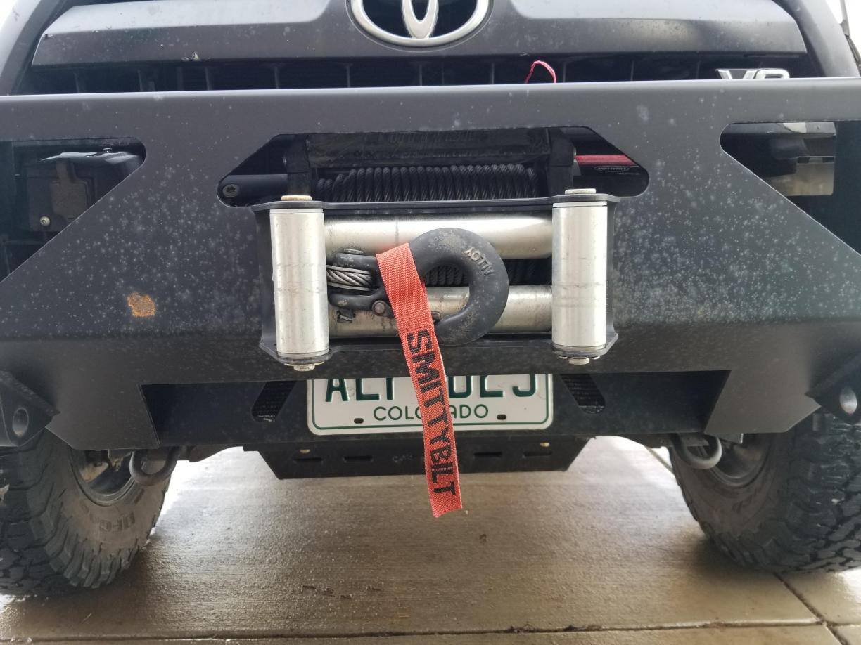

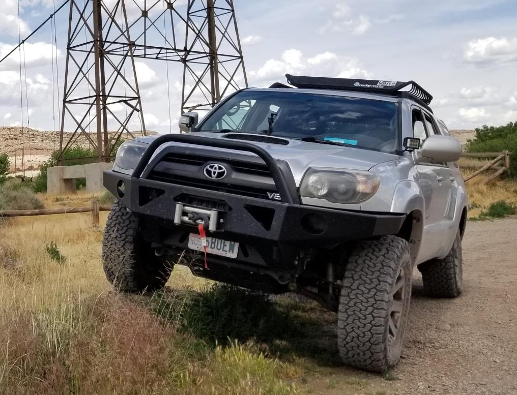

I have the Gen 2 Smittybilt XRC 9500 with the steel cable...my friend just picked one up as well. Seems to be one of the most affordable winches you can get, but that's all I had room for in my budget.
As noted, make sure you have the space to accommodate the winch and control box; look at the dimensions. I have a CBI bumper, my friend has a Relentless Fab one, and the winch fits fine in both of them. I've used mine a few times so the cost has already been justified.
My control box is mounted so that I plug in the controller through the passenger side hi-lift jack access hole (seen in the closeup). My advice is to also get a few shackles, a tree strap, and a snatch block at the minimum to go along with the winch, and watch some instructional videos. Ronny Dahl has some good advice on YouTube.
