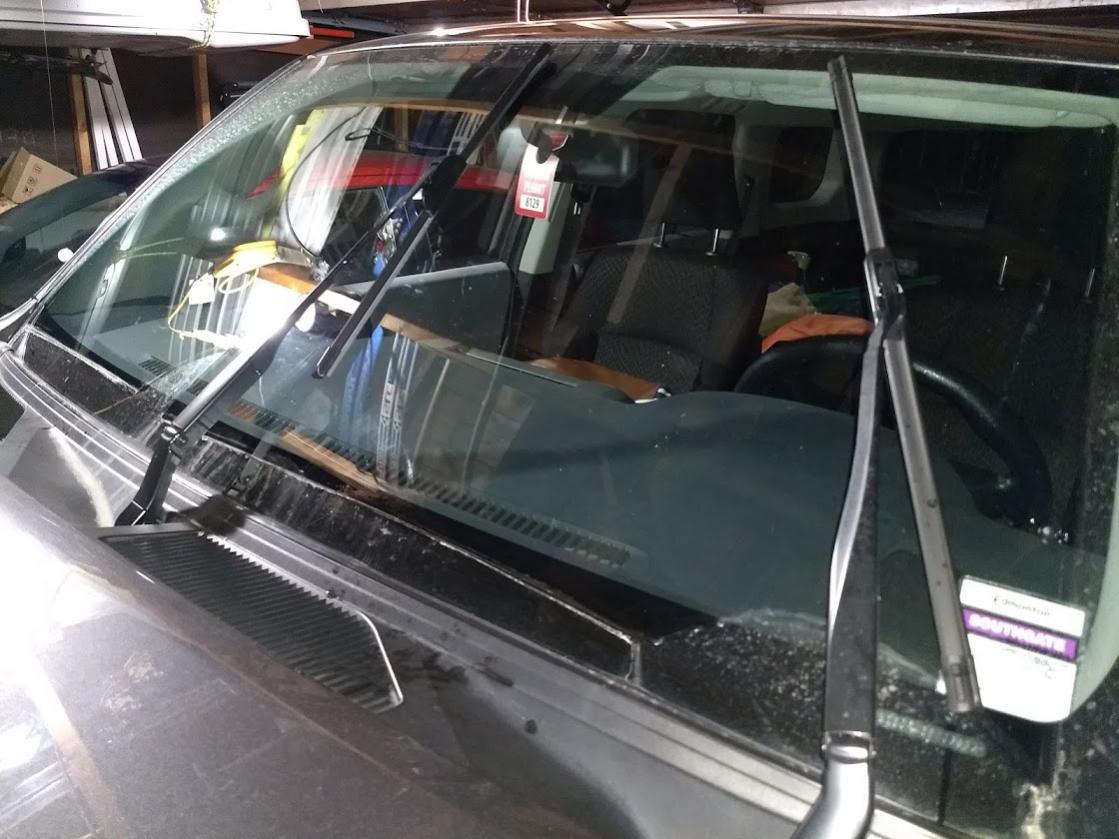

The wiper arm at rest:
The wiper arm near its apex:
From a bit further back:
It looks like you're missing the whole upper plastic piece of the wiper arm.
It's the most obvious things than evade me. Looks like I need to find a replacement part now, and see if that fixes the problem. Thanks for reminding me to look at the big picture.

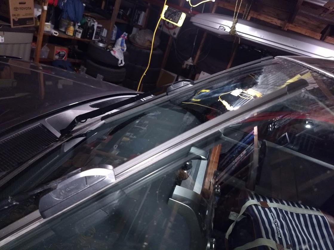

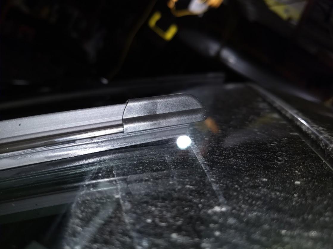

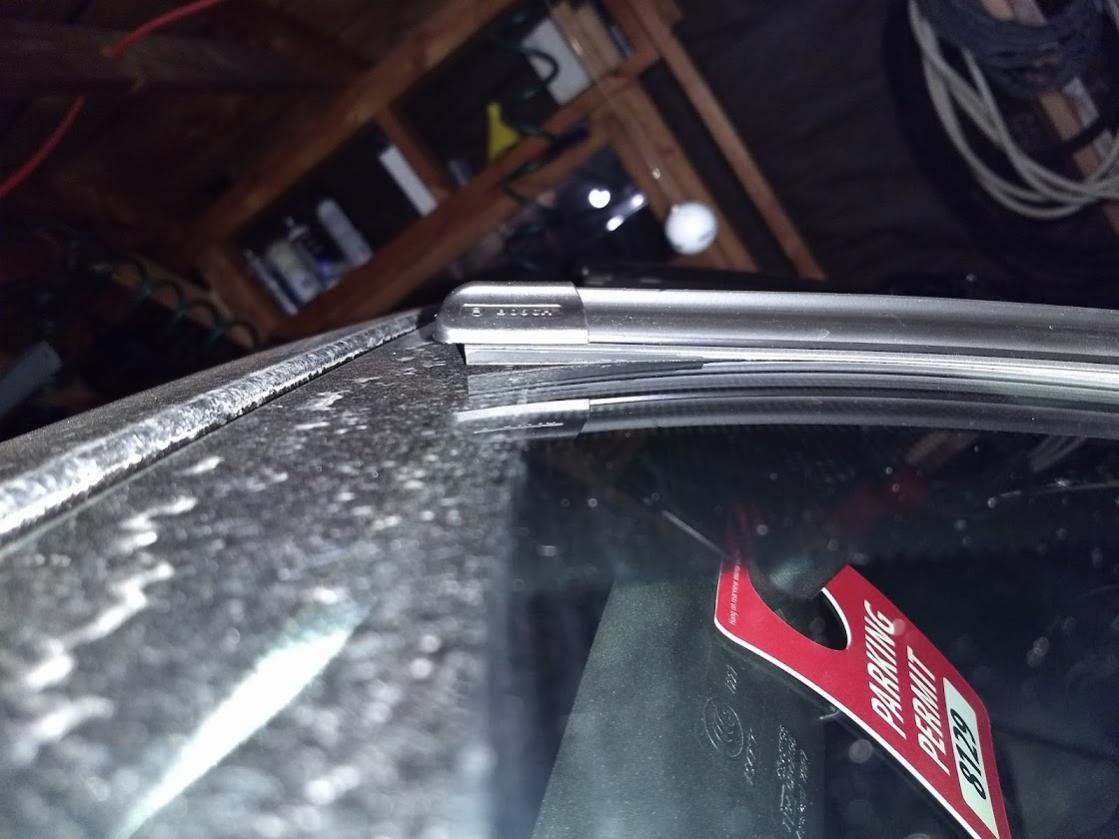

So I spent some time perusing threads and lo and behold found almost my exact issue. However I have this problem with brand new wipers: they lose contact with the windshield at the top for about the last inch or so (on both sides).
I've tried the Michelin Stealth from our Costcos and didn't notice this until winter hit a few years ago. Thought they were just weak or bad but when I replaced them with the same model (after the rubber was starting to harden/streak) the new ones still had the same issue. This time around I decided to try a set of "beam" style to help with winter icing and the Bosch Icons seemed to have the most aggressive curvature.
Well still no dice. See these photos of the brand new Icons (no comments on my messy garage!) :eek:.
Does any recommend any aftermarket that conform to the windshield curvature properly? I'm about to go back to OEM and then just do the insert replacement as required.

Are those factory length blades? The gap from the end of the blade to the edge of the windshield looks small.
