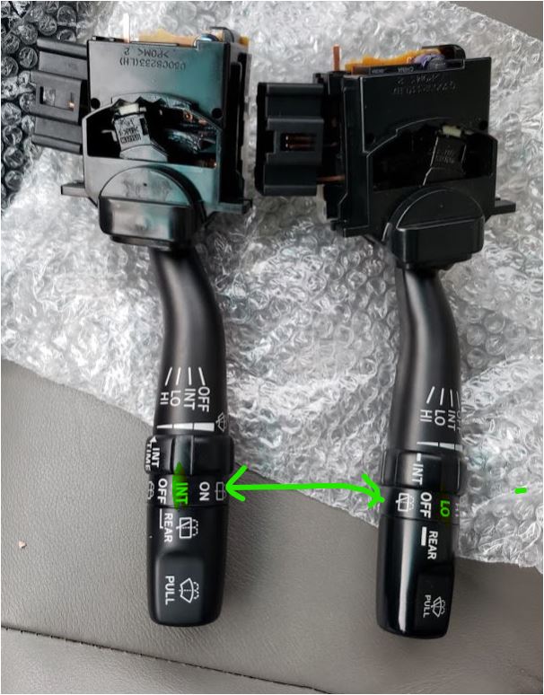

What's crazy is I see two different part numbers for the stalk 84652-14641 and 84652-14642. They look identical but state the former covers all the way up to 2005 whereas the latter covers 2005 - 2009.

I'm believe the differences are within the settings on the stalk. If you look closely some of the print is different between the two.
Ok for those who are in the market for a new stalk. I ended up buying 84652-14641 for my 2008 as it was readily available and actually cheaper.
They are actually identical except for the print. The only difference is High->on, Low -> Int for the rear window. The internals are identical.
Comparison picture
Here is a picture of two models side by side.
