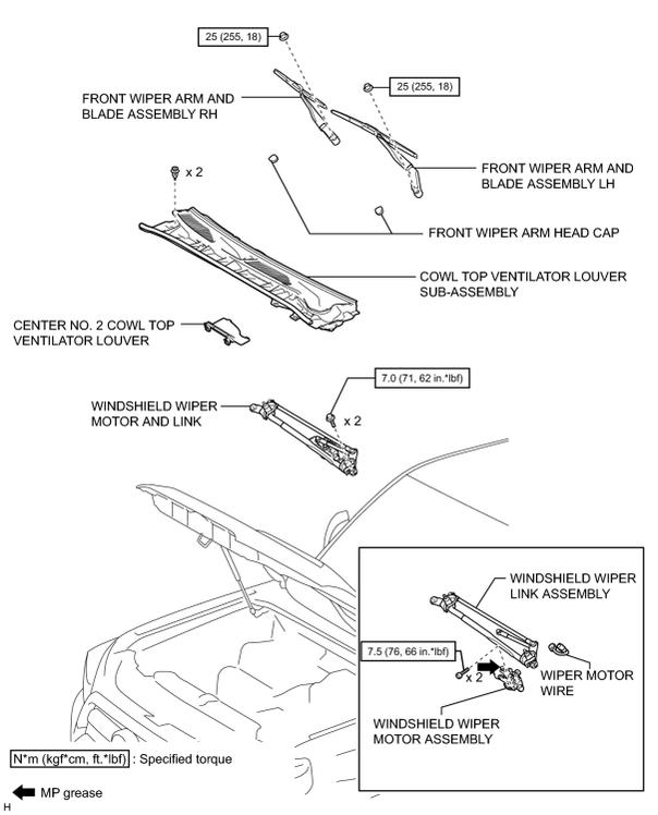

Here's the parts .........instructions are in the factory repair manual found in the mods,write-ups ect sticky for 5th Gens.
