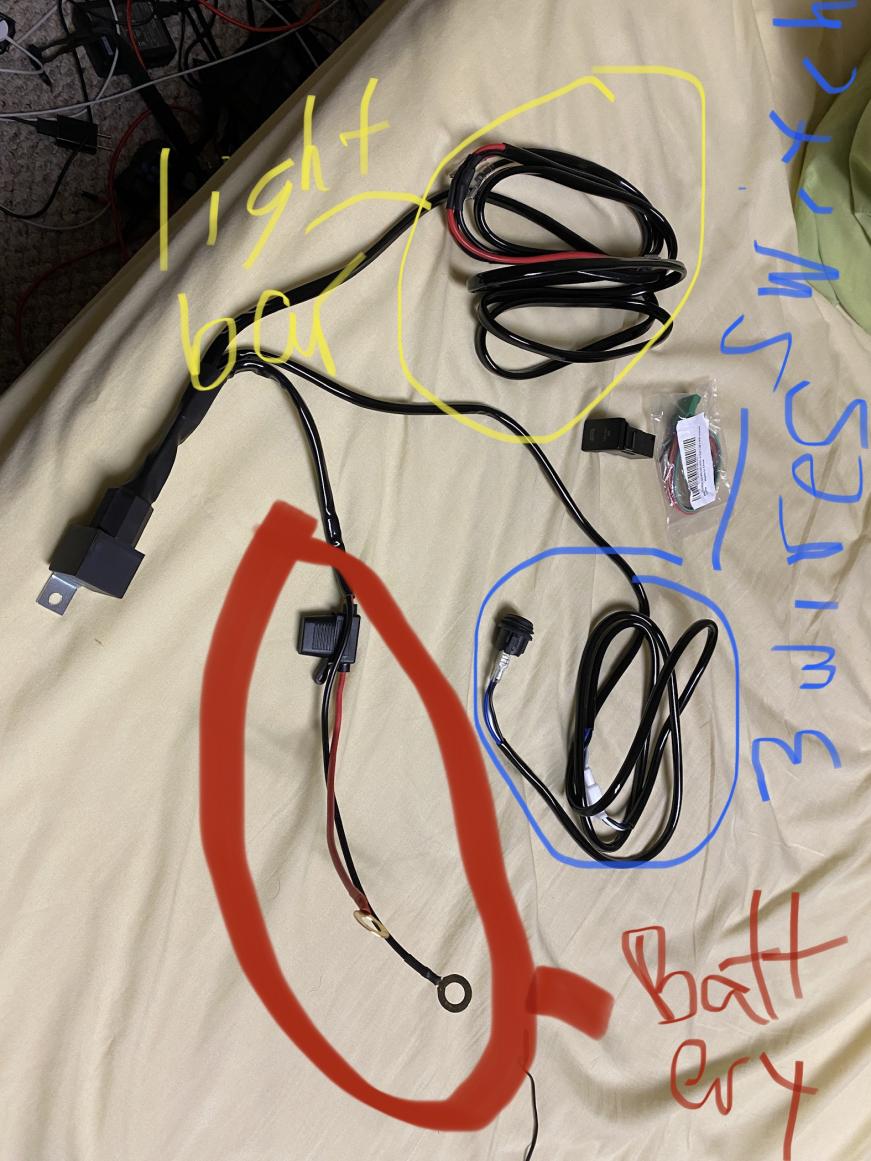

Howdy, I wanna know which wire to use to power on lightbar only when car is on
I have this harness with a 4pin relay. My lightbar draws 12 amps. Do i use one of the 3 switch wires to go to add a fuse in the ignition? Or do I extend the red wire that’s supposed to go to the battery terminal, to go inside the car and add a fuse to it? Or do I use one of the wires from my 4 wire rocker switch to the add a fuse? Thanks

A solution has been pretty thoroughly covered... but my question is how do you not realize your lightbar is on after exiting the vehicle...? Even the most Chinese bars have more than enough output to clearly see it lit at night, and absolutely no reason to be running a light bar when its light outside.. mall parking lots tend to be pretty well lit just about everywhere.. (JK JK)

He explains it pretty well on how to make one of these relay panels to switch on your lightbar. I would add a circuit breaker from the fuse box to the positive battery terminal.
Around 13:00 is when he talks about how the switch (AOB rocker switch or push button) will trigger the relay to power the accessory.
I think you will need to connect a hot wire from the light bar to one of the power screws on the bus and ground the light to a body ground.
Then connect a ground from your AOB to the switch screw.
Another video. He explains how it works around 8:00:
https://www.youtube.com/watch?v=BvFHA1xY10w
Someone can correct me if i am wrong and maybe someone with a little more knowledge can verify if the video is for a negative or positive switch.
Looking at this diagram for a negative switch, i think the two videos are are a positive switch. Here's a diagram and videos for a negative switch:
https://overlandbound.com/downloads/fuse3.jpg
https://www.youtube.com/watch?v=6HcNlI7Mg6I
https://www.youtube.com/watch?v=FWdhmu9TuQk
The white wire and red wire are both going to the positive terminal on the battery. Also note that these guys were using different relays and so the colors are off. Ex. One guy says the middle wire is yellow while the other guy's is red.
