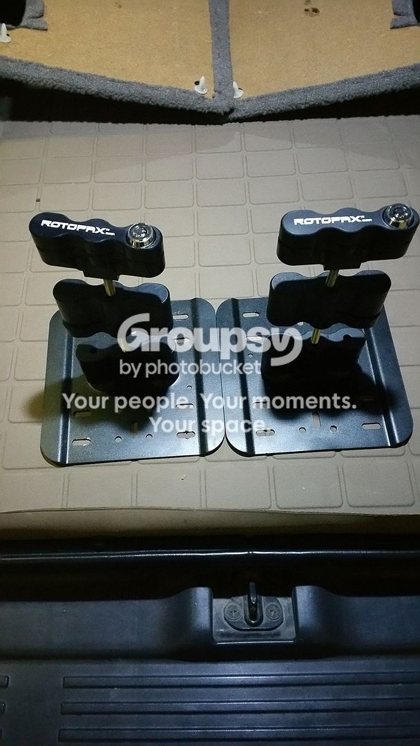

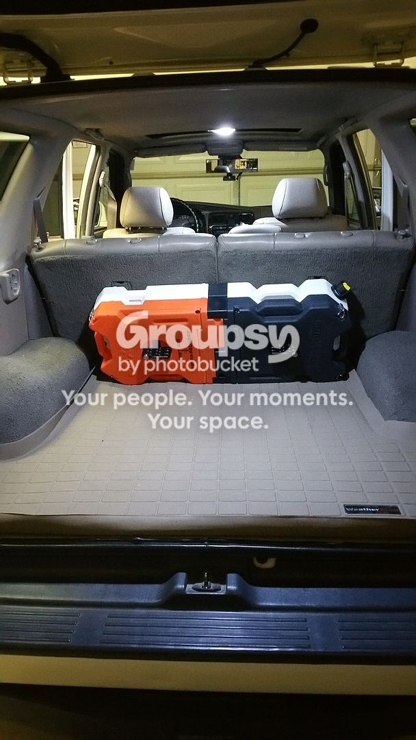

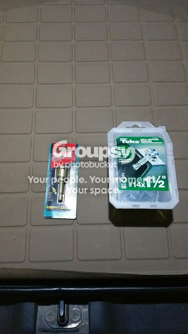

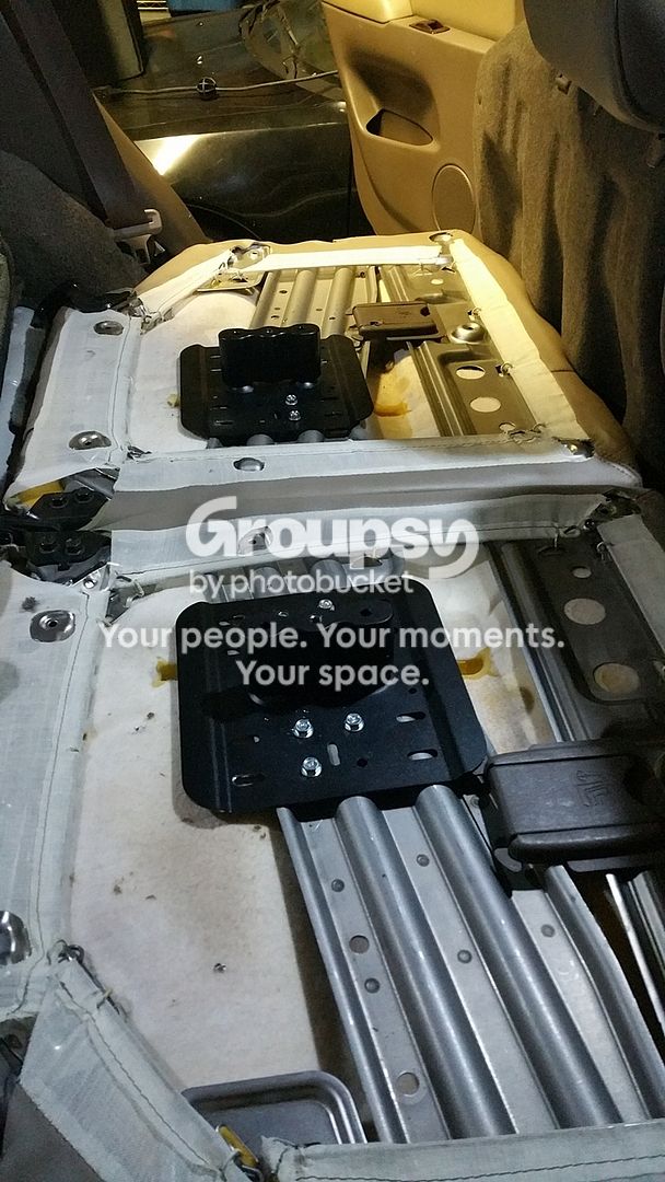

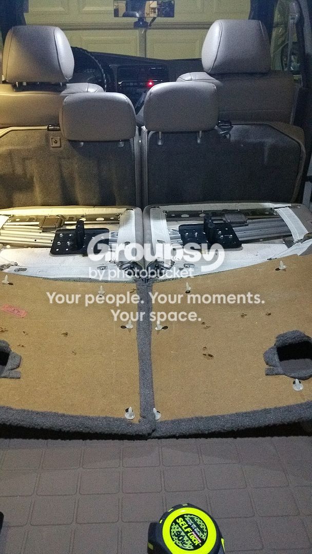

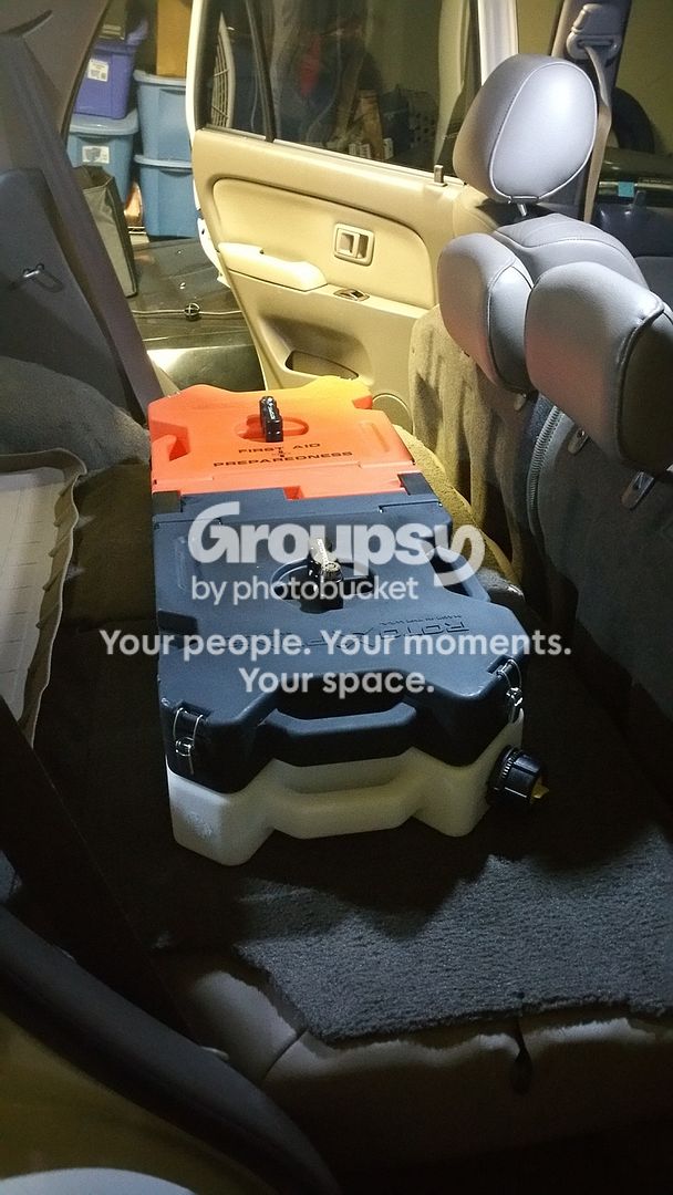

Just in case anyone was ever wondering like I was, here is how I did it. I used 1 1/2 screws to take out any safety concerns. I wanted to install them behind my seats since i don't plan on buying a roof rack anytime soon.

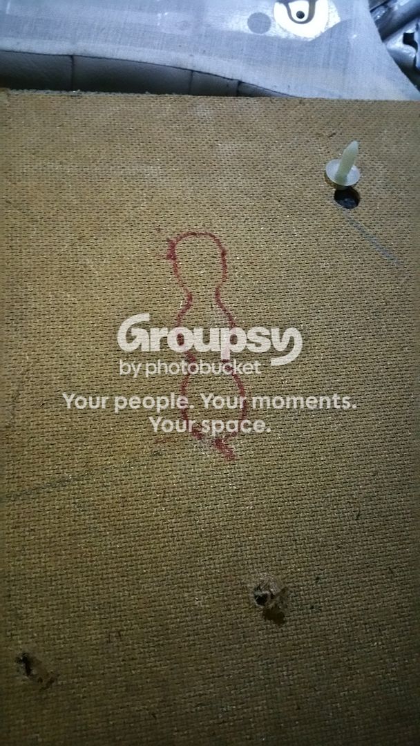

I pretty much just laid the packs on them as a template and drilled one screw in and measured it again.
I then traced out the mount and cut accordingly.

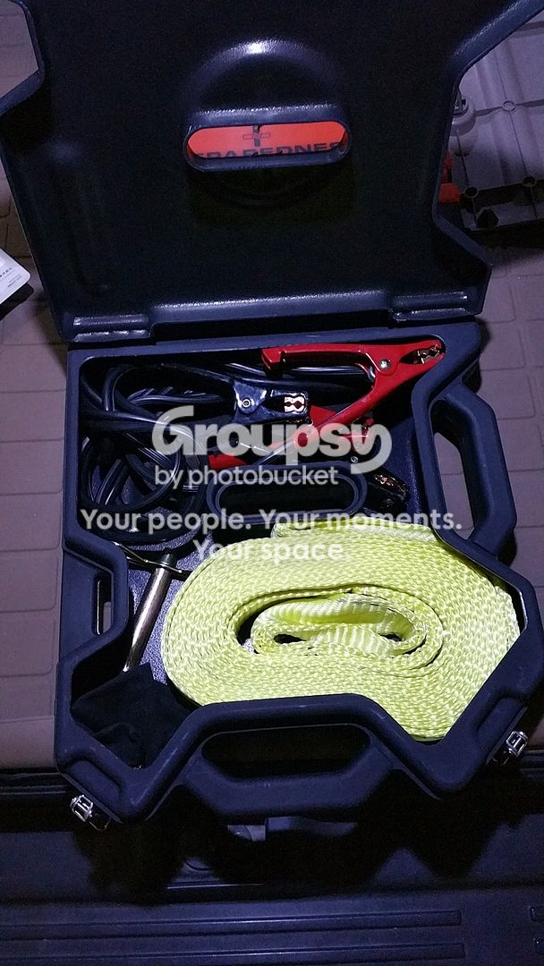

I like the concept and the execution... However, I am curious what benefit this has vs. say a foot locker with 4 gallons of water, jumper cables, strap, and a first aid kid in it?

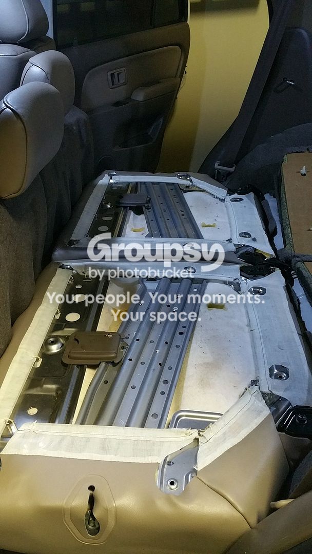

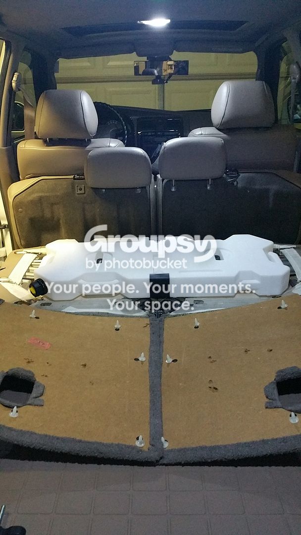

One question though: When you put the seats down, like in this picture...
20150714_005441.jpg~original
Do you have to put both seats down at the same time? In other words are the seats connected together now? Can you put just one seat down and leave the other up?
Pretty neat!
Thanks! You dont have to. If you look where both of the PaX connect there is a little black clip that keeps them together. If you disconnect, you're able to open both individually.

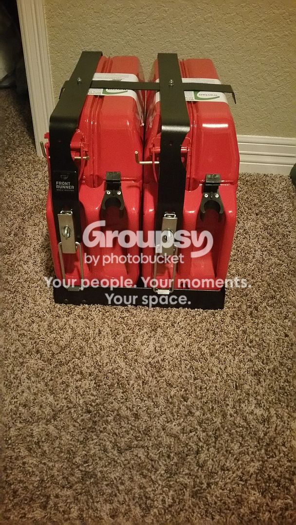

I was thinking of getting one of those Front Runner jerry can holders. Are they pretty sturdy?
No they are shit. No idea why they have a lock, you can bend the cross strap and push apart the other straps. Suppose its enough to keep it on the truck, but not enough to keep it from people.
