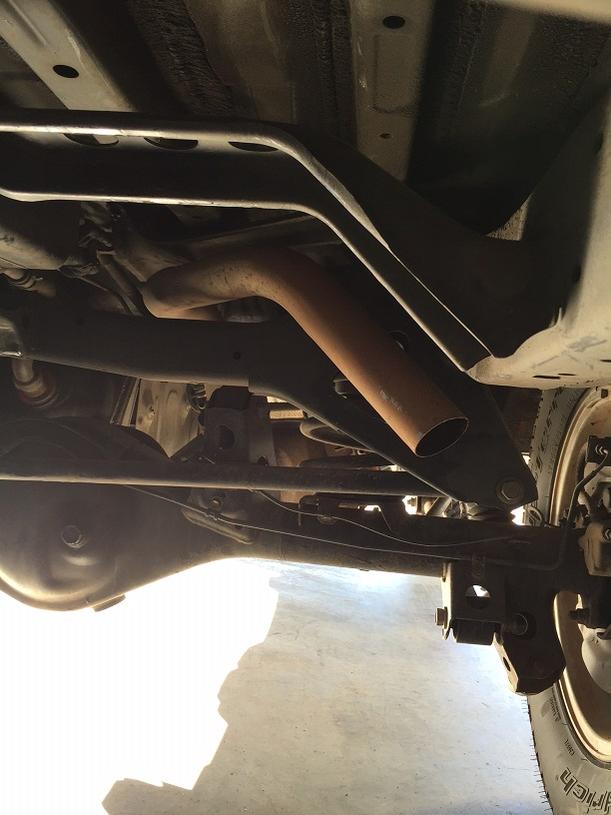

Thanks! I'm really on the fence about it. I don't like the resonator there either but my issue is I've had cars in the past with exhaust systems and I hated it after a while. Especially with the v6 I just haven't heard an exhaust I like yet and I'd much prefer it to be quiet like the factory. I may just cut the resonator off behind the axle but I've heard mixed reviews of the difference in sound.
I cut mine at the turn down, where the exit was still above the rear axle. The noise difference, if any, is minimal. I did this for added clearance as well as I dragged my exhaust when climbing.
