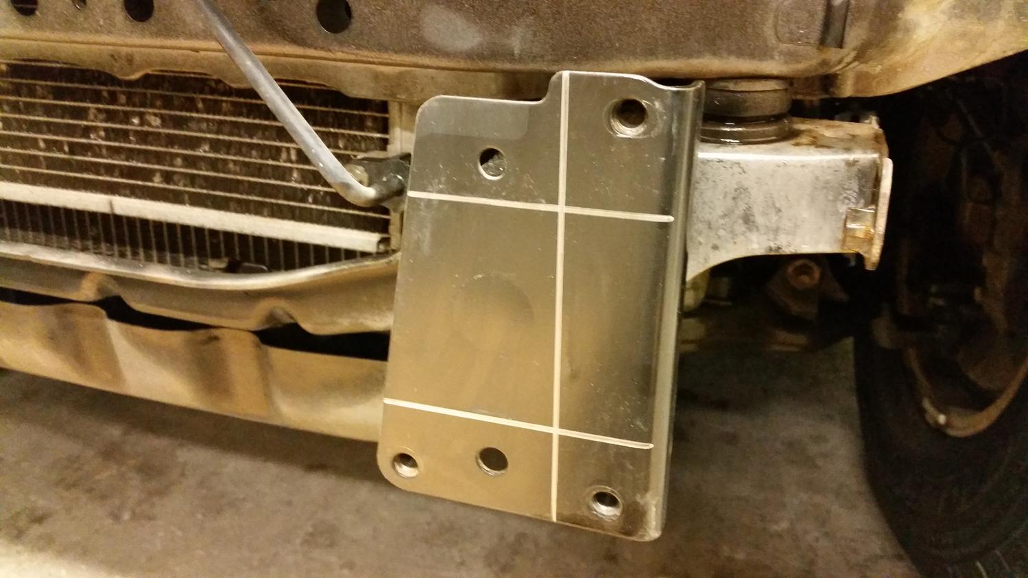

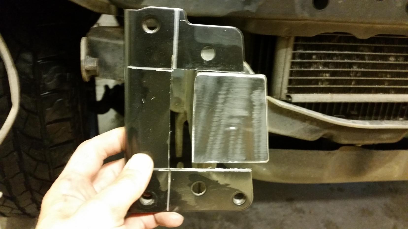

Progress today- not much. Basically, I'm rebuilding this with reproduction in mind, as well as a feasible install for folks. Right now, I don't see a way around needing some welding for the install. Hopefully that isn't a big deal as it's not much welding at all. Here's a couple shots of what will need the work. The first picture shows the factory bumper mount marked out to be trimmed, the lines are right on the factory welds since they will need to go. Next the cuts are made and your left with the remnants of a few welds to grind down and un-cap the frame rail. My plan is to make a new plate to be welded back on, to which the bumper will attach. More to show tomorrow!
