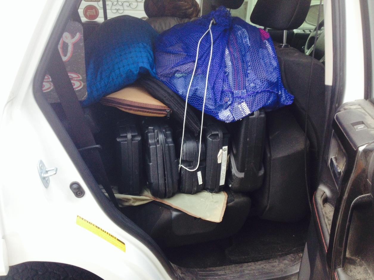

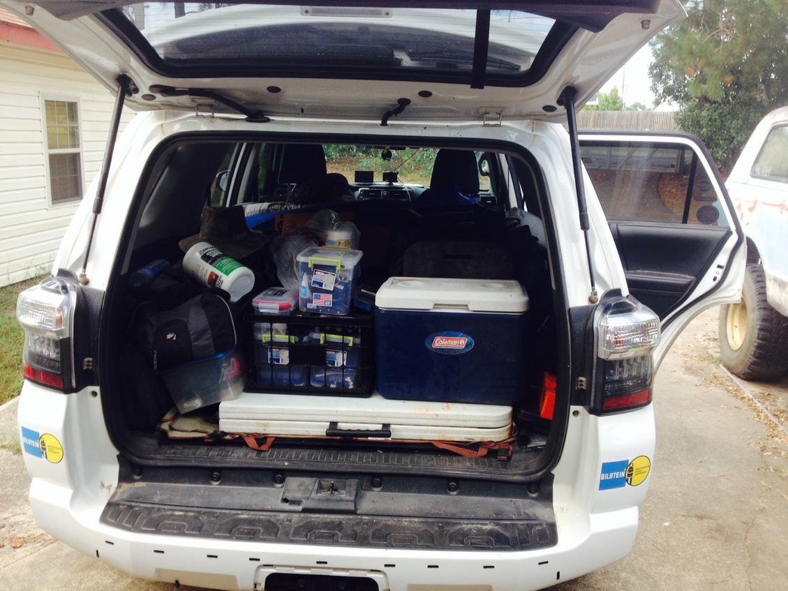

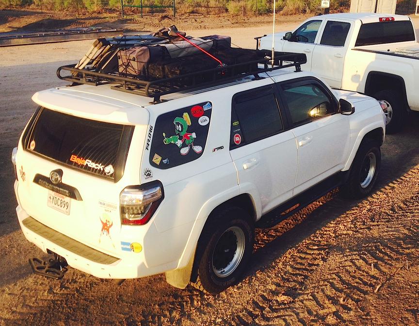

I did a trip in late 2014 with a similar load (mostly guns and ammo). With a full tank and my "muscular buttocks" in it she weighed out at 5,840 lbs on a truck stop scale. It floated like a mid 70's Cadillac but the ride was controllable and comfortable for the entire 1400+ mile round trip. I had my 5100's by then but was still on factory springs all around.
