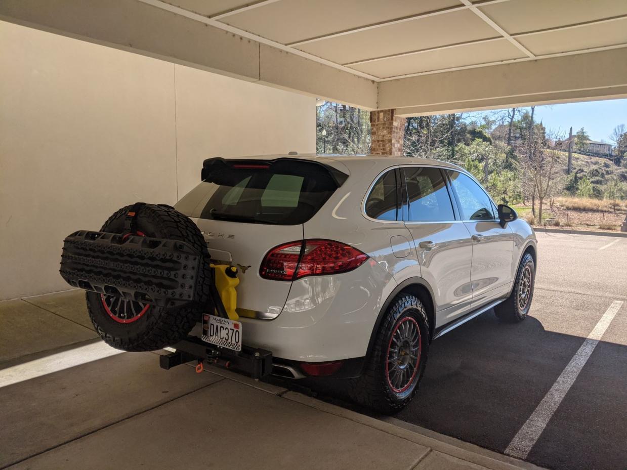

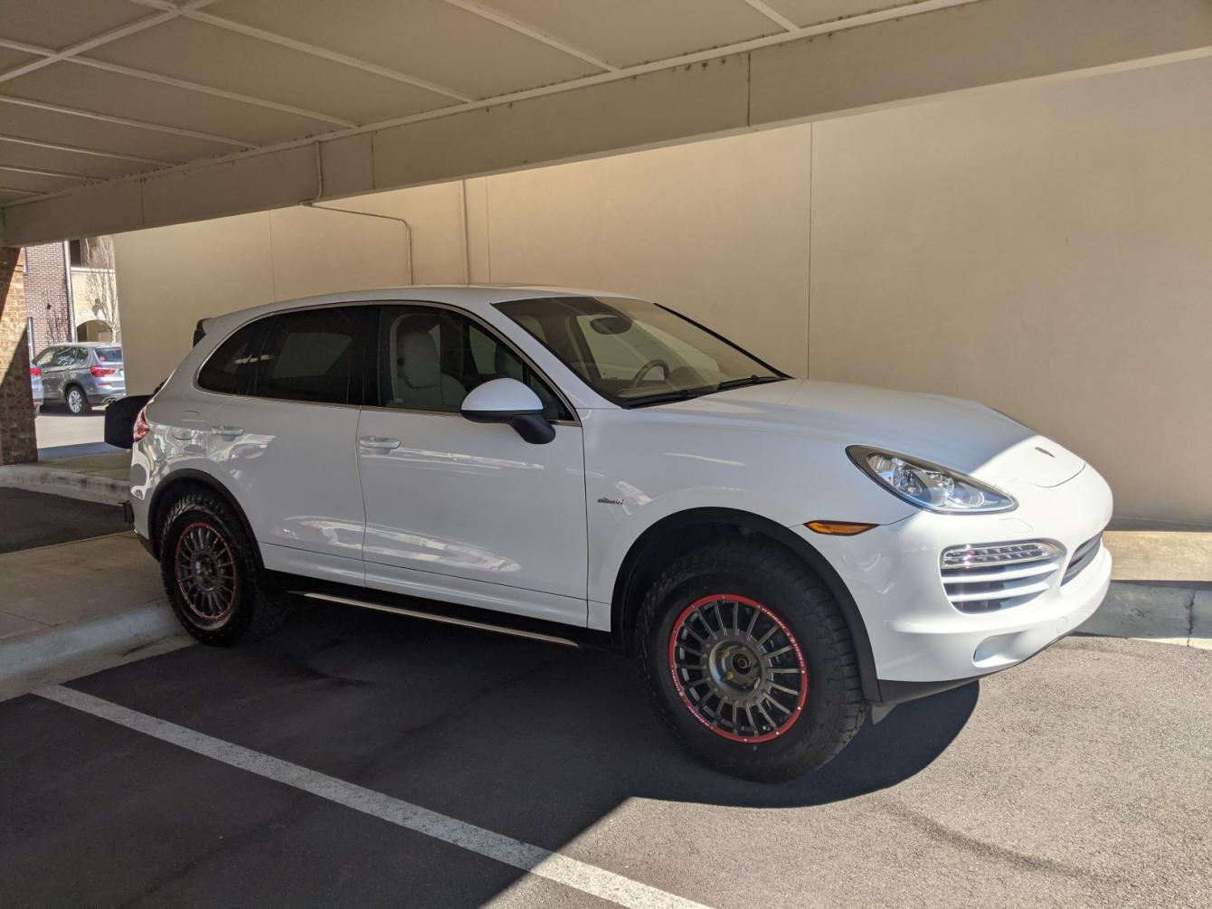

Can't tell if you're being sarcastic or not. I don't see anything wrong with a Porsche Cayenne burning by you on a mountain pass. IMO those things were made exactly for mountain passes. It has a ridiculous amount of power. Buddy of mine had one and it was smooth and powerful. Also I think CR did a survey lately that showed Porsche being the #2 most reliable brand. #1 was Lexus.
I've seen a few YT videos of them going off-road and I think they're more capable than one would expect. I saw a lifted Cayenne the other day and did not hate it. Actually, it was kind of badass.
