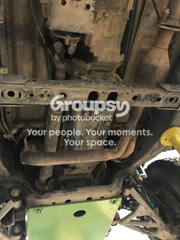

..Just for reference, here is a stock 04 Limited. I think there may be a change from 05 and up. I'll put my car (05) up tomorrow and compare pics.
V6 and V8 might be different too. My 05 V8 looks way different than that. Crosses over behind the crossmember and no rear resonator before the y pipe. Without looking at the part drawings I would say there are at least 3 different exhaust setups. One for each of the V8s and at least one for the V6.
IIRC, you are correct. i have access to all 3. Now, I'm currently gathering piping to make y-pipe. i will make my own thread once i get started.
OP, excuse me for the thread jack.
Ya there's also California spec and not. Cali spec has 4 cats, 2 on each side. Regular had the cat on each manifold then 1 after the y comes together. Mine was cali spec and as [MENTION=130999]Inv4drZm[/MENTION] described.
Sent from the drivers seat of my 05 4runner.
Good to know. I was under the assumption that all 4th gens were Cali spec. regardless of what state it was sold in.
I would think so too, but I've seen several with only 3 cats. Not sure why they did that. Maybe it's a year thing, not 100% sure.
