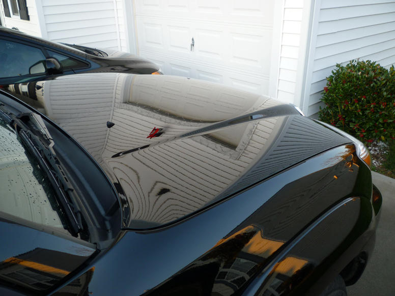

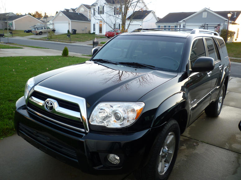

I also did the clay bar for the first time and then applied wax i was like WOW! it works very good and pulls out all of the crap that is trapped in the clear coat. Here are some pic's:
