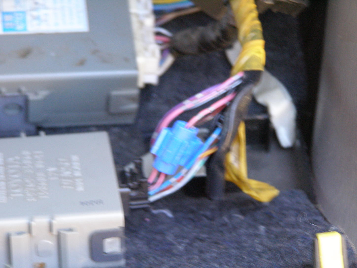

Write-up: 08 and up TPMS disable
having fun
Sorry guys, It took awhile for the light to come on. Still working on it. Posted on the gen4 form.
Edit:
Ok my connector moved and wasn't making a good contact. This does work as I moved the wire around and the light would go off and move it again and will come back on. So you might give this a try.
Not sure if it is the same connector for you guy, just thought it might be since the change is on 08 and newer for gen 4.
PINK W/ BLACK STRIP AND BLACK W/ RED STRIP. Just make sure you have a good connection on the wires.
