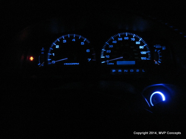

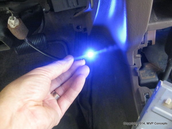

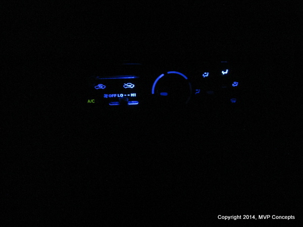

Did the blue LED upgrade, and this was good to read and refresh on what to do...

I used the ones from SuperBrightLED and they're plenty bright for the dash. Those don't look like they're going to fit by the way the base looks. Those look more like #74 bulbs to me, but it could also just be the picture. If they're #74's those are what you'll use for the blinker bulbs on the dash, and those are going to blind you. I'm using the #74 3 SMD bulbs from SuperBrightLED and I'm thinking about swapping them out for something a little less bright.

Well guys I put the LEDs in the cluster and hvac but only the hvac ones work so now I'm stumped. It start raining so I can't do anymore till tomorrow
At the beginning of this thread it says to use #24 for the gauges but you said you used #74. Which is the correct size?
#24 is the correct size. I wrote #74 but the link is to the #24 bulb. Edited post. Sorry Phd. Stupid question but did you turn them 180 degrees? Do the highlanders have the auto climate control?
Ya I turned them till I couldn't anymore. No they have regular hvac controls like the sr5
