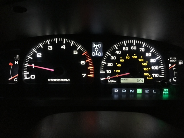

#24 in the gauge cluster. Autolumination has a variety #24 bulbs with multiple led arrays on them. #74s are way too small.
What color are you getting. I used white. Really shows off the colors
That looks pretty good. I know how difficult it is to take accurate shots in the dark, so I can't tell if that's a hot spot at the 2 on the tach and the 80-100 on the speedo. Are they uniform?
No it's a hot spot. Not really that noticeable to the naked eye. Very hard not to have hot spots with LEDs.
That's been my struggle lately, trying different LED bulb types to find the best compromise, but none have left me that satisfied so far.
