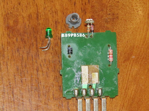

Also our ECT button does not have a neo-wedge, rather a soldered in green light. This also needs to be updated if you can.
I had to de-solder the old green light, which wasn't too hard since the solder points were large, and then take apart the neo-wedge I'd bought and solder it in. Worked pretty well.
