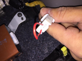

Thanks to all who posted and especially to Subspd, whose pic was very helpful in determining exactly how to place the jumper. I went that route because I didn't want to cut wires and wanted something easily reversible.

So I jumped the black/white with the pink/black like mentioned. Light is off but sometimes it takes time. I just got my winter wheels on and wanted to get rid of the light this year.
A few pages back I posted this...
Just jump the wires and leave it UNPLUGGED this way you don't have any spliced wires. If you ever want it to work again all you do is plug it back in! Easiest mod ever.
