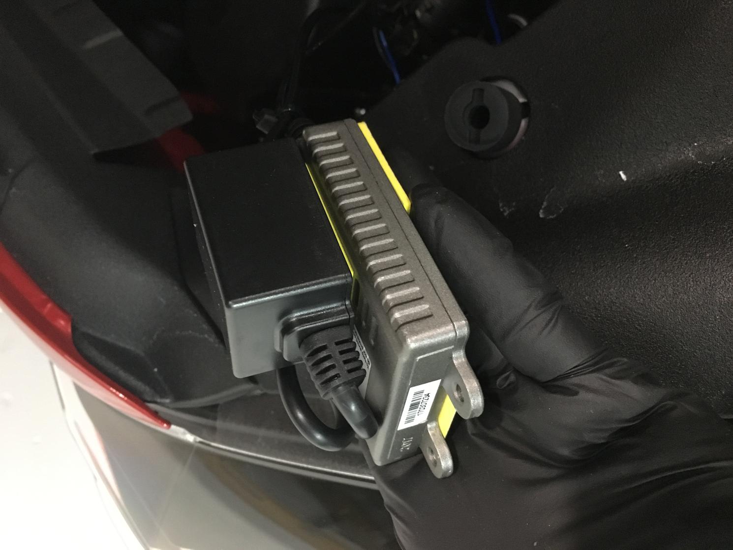

The two relay harnesses (with positive/negative connectors) that came in the box don't apply to 5th gen setup correct? I'm guessing they were just included because this kit serves other vehicles as well?
Also, will securing the ballast together with this block like I have pictured behind the plastic flap above the wheel well created an issue from heat or anything else?

[MENTION=167950]CZ-4Runner[/MENTION] - Correct, the ballasts that come in the Xtreme HID kit are low draw, which means that you can safely power them right from the 4runner's OEM headlight wiring. They way you have it set up is fine, although I wouldn't rely just on the double sided tape.

Thank you. I also used plastic ties but really was concerned about heat issues.

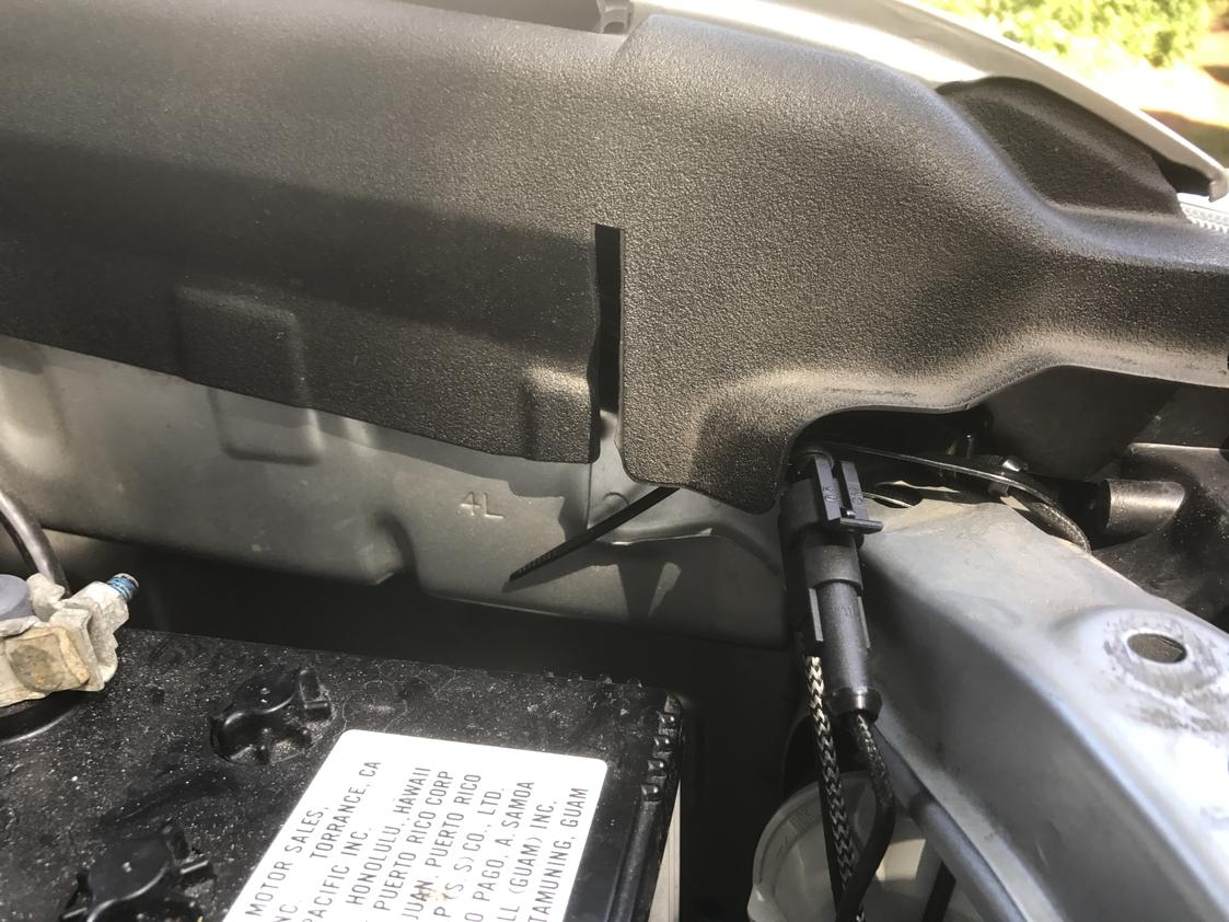

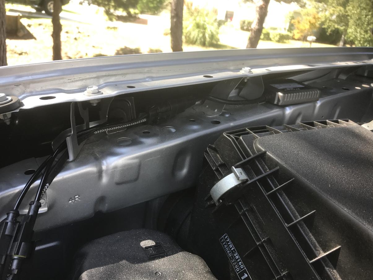

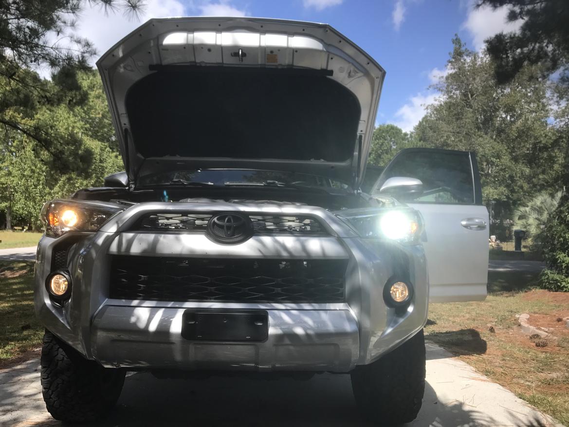

Installed the HIDs this past thurs. Pretty easy overall. I ended up not using the relays. I placed the ballast behind the side cover above the wheel well and it hides them perfectly. What a difference! It looks so much better and great visibility driving. Of course I ran out of time to make adjustments and had quite a few people flashed me on my morning commute. Made more adjustments so we'll see how that goes. Now I need to upgrade the fogs!
