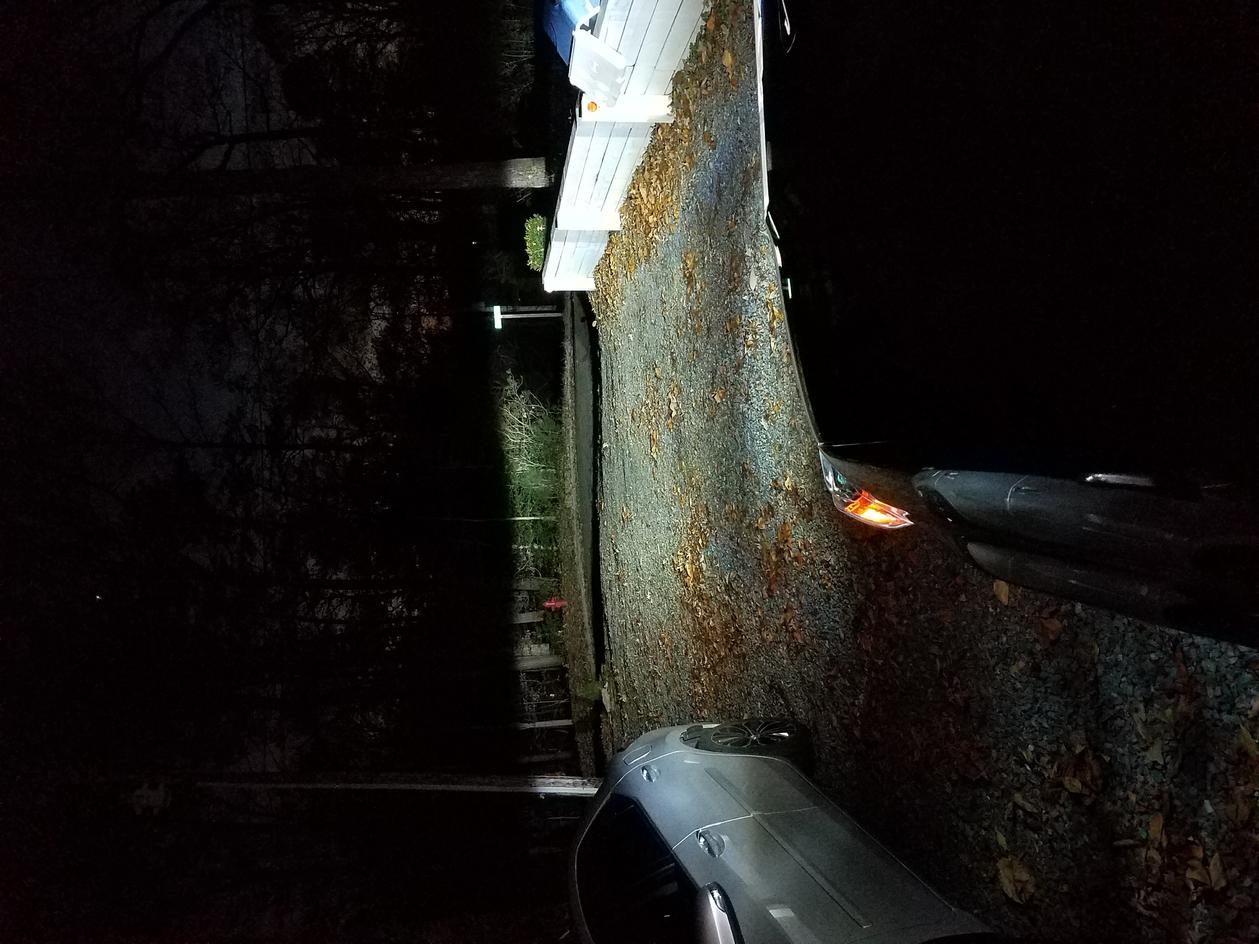

XenonDepot HID vs LED, initial photo. (Pics reposted)
The bad: short light zone, no additional throw; and terrible in dark, rainy weather.
I'm finding similar results. The short drive I took after the install tonight went into a small valley where there was a little fog. The new bulbs had me freaked out a bit because I couldn't see as much or further than I have been able to even with the Sylvania bulbs.
