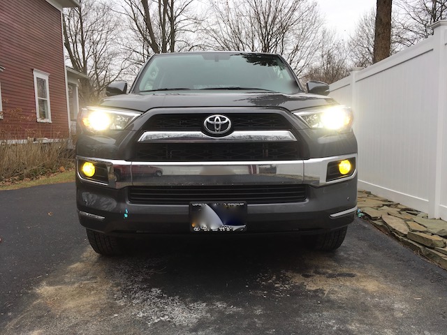

Just installed the H11 HID kit 5K and the H16 Philips yellow LED fog lights from Xenon depot. Ordering was straight forward and easy, received the lights within 2 days and install was easy. I love my set up and the light output turned out great. Thanks Xenon depot !!!!
Pic 1 of both HIDs and LEDs installed.
Pic 2 of driver side led fog and passenger side stock fog
Pic 3 and 4 of the LED fogs in with stock low beams

Took out the LED's and evaporated the water in the headlights with a hairdryer and installed the Philips HID's....
They look great in the day light with the Yellow Fogs...
