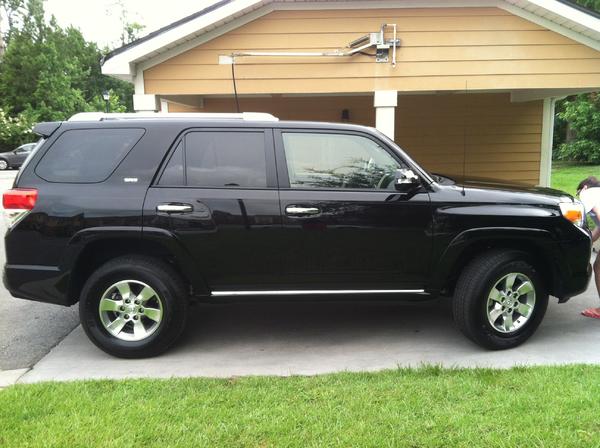

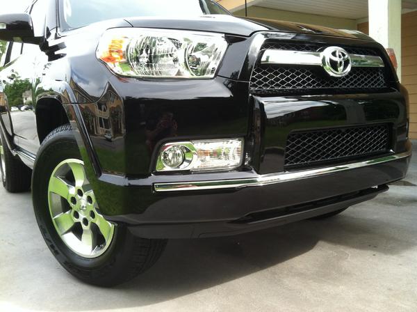

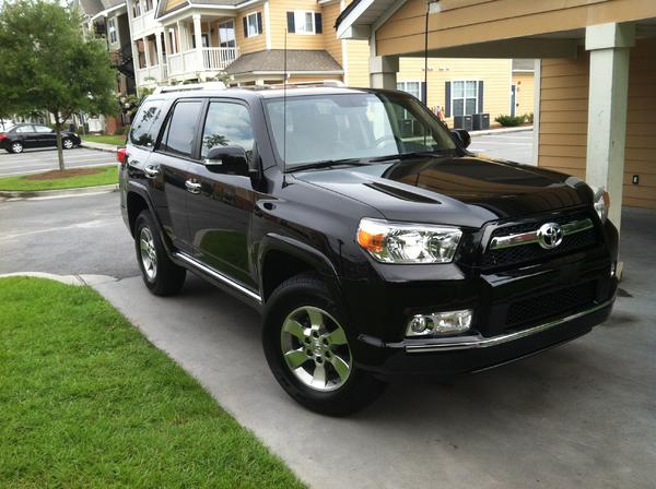

Good news though the detail went well today. Learned that I need to buy a hose filter because our water is really hard and has a lot of minerals. Here's some pics from the detail and if anyone needs any detail tips just ask.
