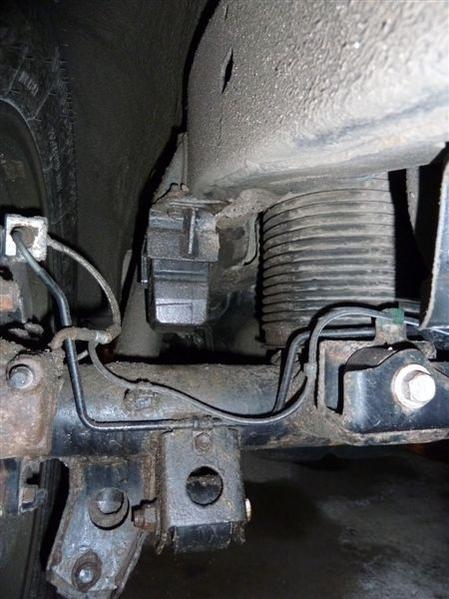

I am ditching the XREAS on my '06 V8 LTD with rear "air" suspension (pic at bottom).

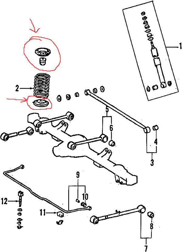

For the rear I plan to buy brand new OEM Toyota 4Runner springs. My limited research suggests that all '03-'09 4Runners without XREAS used the exact same rear spring part number, regardless of whether they are V6, V8, 2WD or 4WD. Does this sound right :confused:
None of the XREAS removal posts mention adding the rear spring bumpstops and rubber top "insulators" (see pic - circled in red).
Why not????? It seems to me that these items would be required to do the conversion correctly. Perhaps this is because most 4Runners don't have rear air like mine does?

I reused the bumpstops when I replaced my springs with FJ springs. You'd probably have some pretty awful squeaks and rattles without them!

You were able to reuse your parts because they were present on the vehicle :D I don't think the XREAS-equipped 4Runners have these parts.

The simplest thing is to stick your head under the rear bumper and see if you have coil springs. I've never worked on one with a self-levelling rear, so I can't comment on whether they have bags inside/in addition to the springs, or bags alone. Let me know. That'll add to my knowledge base.
Mine has the air option.
Does this mean I need to buy the rear coil springs plus the rubber spring seats?
yes, if you have rear air you need coil springs to replace air bags, note that little fabrication will be required for this conversion since rear air option does not have a way to hold coil in place.
