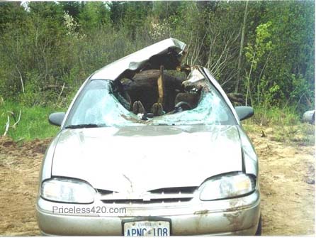

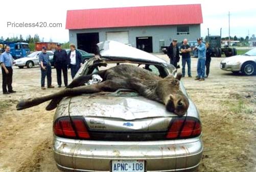

Here is why I would always try to avoid an animal like this:
