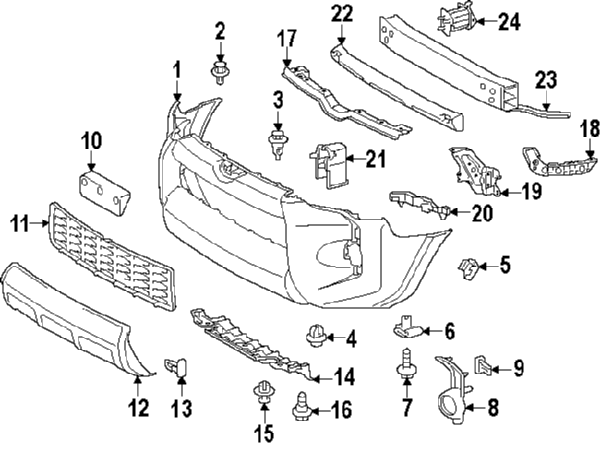

Thanks for posting the information regarding the facelift headlights and 14+ bumper! We have a 2011 Limited and I don't really like the bumper options for it. Other than the headlights and center upper grill, was there anything else you needed to modify or buy to make the newer aftermarket bumper work?
Thanks again
Thanks again
That is it! There is a upper support piece that I didn't buy that would be a good idea to get. It's #17 in the attached diagram. It will help solidify the mounting points for the headlights and upper grill. Im not running it right now and my headlights vibrate pretty badly on really rough roads/trails. Will eventually get it.
A couple of additional things:
•As mentioned somewhere else you will need to add some slack to the passenger side headlight wiring harness. I did this by cutting away some of the loom/electrical tape. It will be a tight fit but it will work!
•The side marker bulb holder in the headlights will need to be trimmed down a bit to fit the newer style headlight. Not a big deal (I used a dremel).
•There is a center sheetmetal piece that the pre-`13 bumper used to hang off of. You can safely remove it.
Let us know how it goes!
