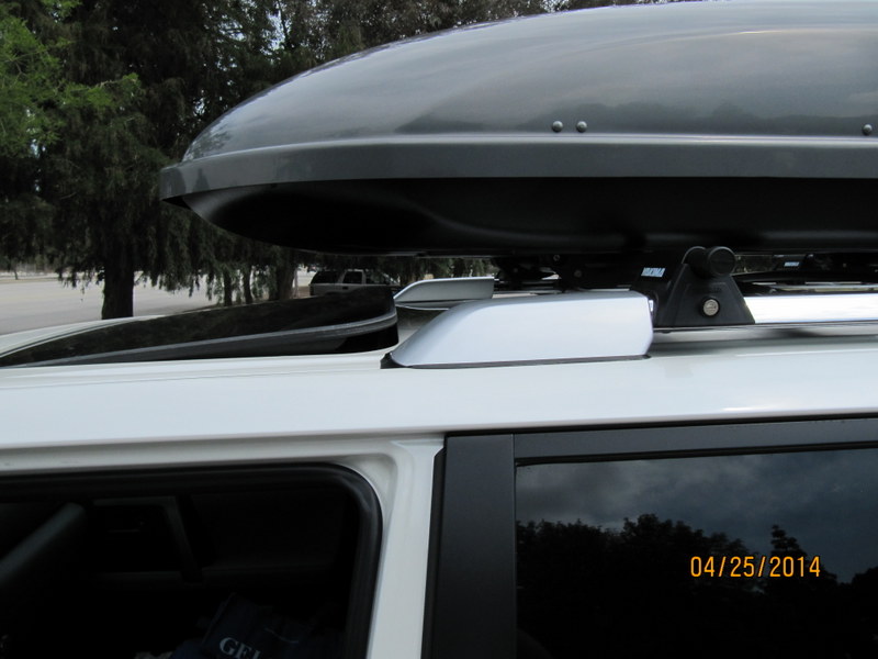

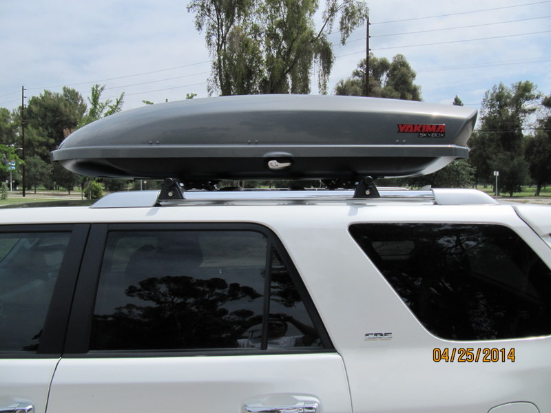

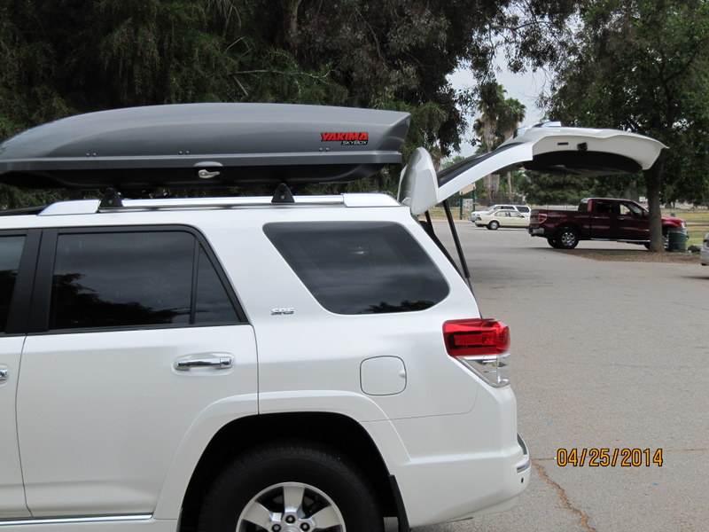

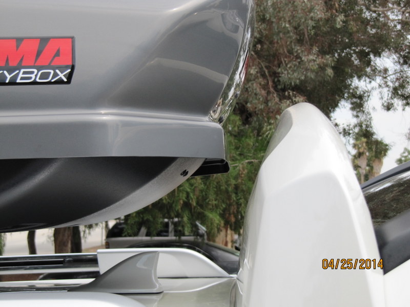

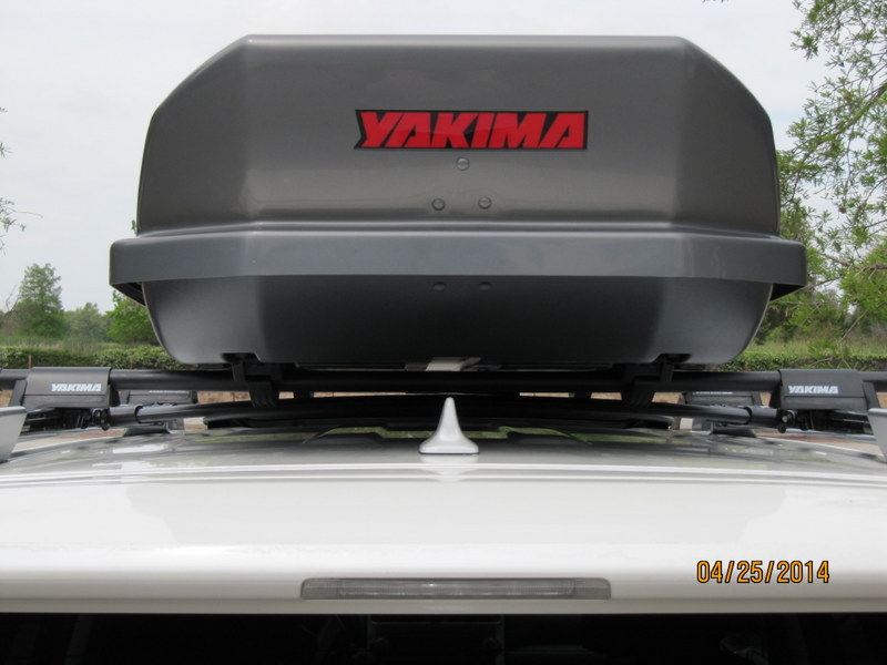

I used a lot of the information I found here to make my decision on what roof cargo box would fit on my 2011 4 runner. I decided to play it safe and install the Yakima skybox 16 with the Yakima rail grabbers and 48" cross bars. It all worked out. I have the factory crossbars still installed and I think that is causing a bit more noise with the Yakima crossbars when the box is not installed. It could be air turbulence between the bars. I decided on the Yakima cross bars because they raise the box so the latches won't hit the roof and its easier to install ( after first set up). It clears the spoiler (when opening the hatch), the sharks fin antenna, and the sun roof. XM reception was not effected.
Just drove from LA to SLC round trip. noticed a little increase in wind noise. noticed a lose of about one MPG at 70 MPH. not Bad.
NOTE: I installed the Yakima fairing to the cross bar when the box is not installed and this eliminated the wind noise.
Hope this helps
