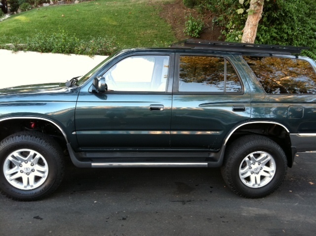

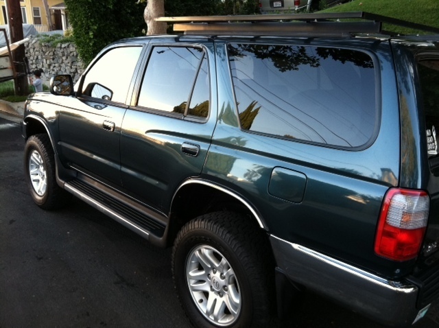

Im reading various threads and seeing conflicting info on 17" Tundra rims....are these rims I have lug or hub centric? I found a place closeby that has the Hunter Road Force Balancer, the lady didnt know baout a Haweka Adapter. Its $15 a wheel, figure if I know exactly what to ask for and if I need the Haweka thing and they have it, to bang it out tomorrow if they have time. If it kills this highway steering wheel shimmy that is there sometimes and sometimes not, Ill be a happy camper not worrying about if its ball joints, wheel bearings, or bad tires.
Just not sure about what year the Tundra rims are the previous owner put on and if they are hub or lug centric...so I can know what to ask for and if the shop understands what Im saying (or else Ill pass)
Thanks
all 6 lug wheels that come from toyota are lug centric. one way to know for sure, with the vehicle properly lifted (wheel of the ground) remove the lugnuts. if a rim is hub centric (providing the vehicle which our 3rd gens do, have a hub lip) the hub lip will hold the rim in a centered position. it the rim is lug centric, upon removing the lugs you will see the rim move alittle as it is no longer centered
thanks, took it to only place in town that had the Hunter Road Force balancing machine...they didnt have the Haweka plate (broke it), but said they install lug centric aftermarket rims all day long and it would still work good....$15 a wheel I said what the hell worth a shot...
So the front right wheel was out over 3.5 ounces combined (I think thats what he said) and left wheel combined out over 1.75....he said that definetly would make a difference being that far out, so this should help?
And nice of them to do a 31 point inspection I didnt know for free, said my left rear brake needs adjusted, takes two hands to turn it, and my right rear axle seal was leaking...which a month ago a Toyota dealer did both an entire rear brake job and the rear axle seals, and I already took it back once since I smelled something, and the dealer said it just needed cleaned up and the one side adjusted...but thanks to these guys, I called the dealer again today and Tuesday they said they would take care of it so thats good...I dont want to be paying for more brakes and axle seals!
