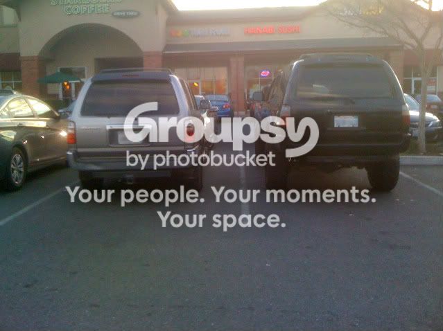

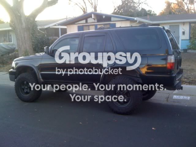

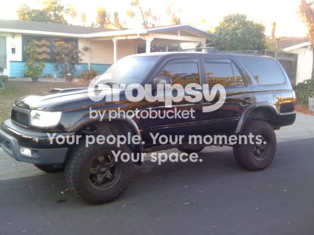

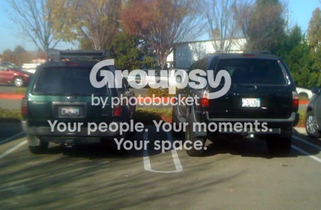

Took a pic next to a mostly stock looking 4Runner, next to me at costco, to compare....and make me feel cool. Oh, by the way........Sam's Club > Costco.
2-14.jpg~original

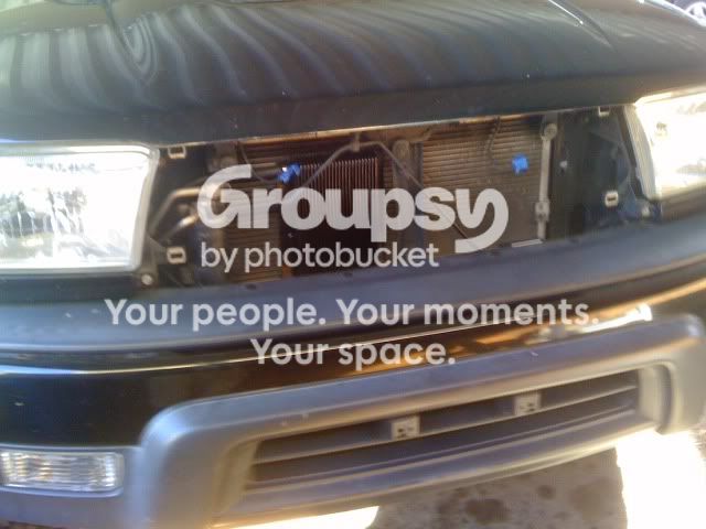

Finally put in the B&M 70264 tranny cooler.
IMG_1206.jpg~original

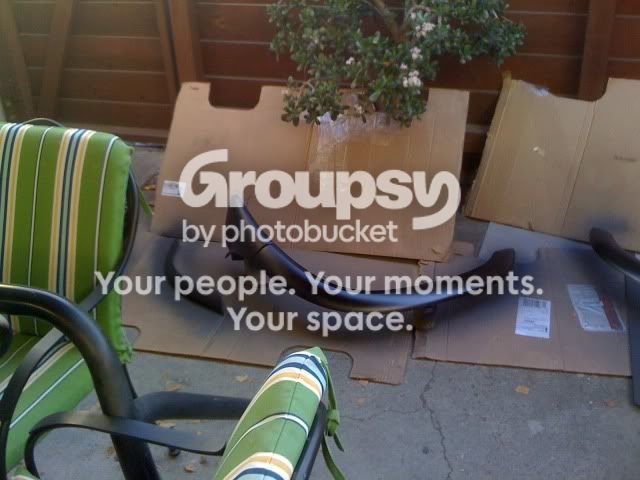

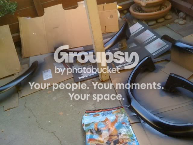

and painted the fender flares and bumper step cover thing, using my high end paint booth
IMG_1185.jpg~original
IMG_1186.jpg~original

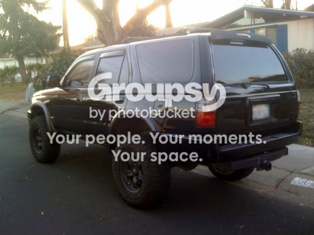

annnnnd reinstalled
IMG_1198.jpg~original
IMG_1197.jpg~original
IMG_1196.jpg~original

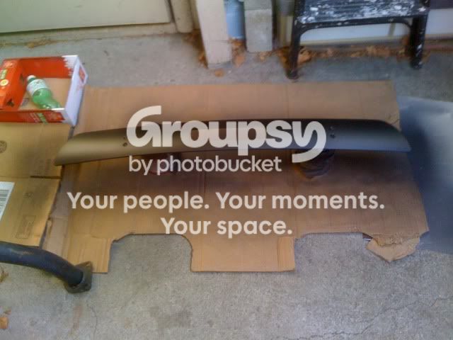

Painted the rear spoiler thing.
IMG_1205.jpg~original

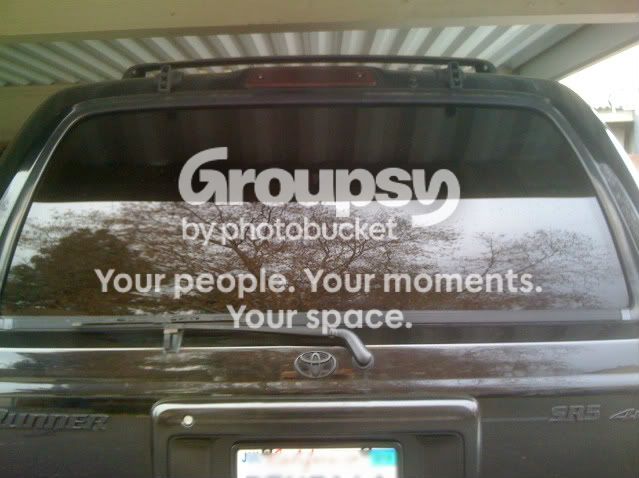

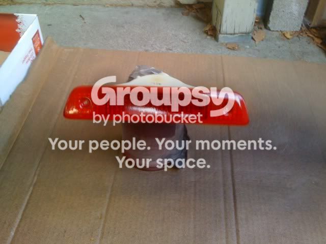

and tinted the 3rd brake light. Note: in order for the spray tint to stick to the 3rd brake light, you need to spray on a clear coat first. The tint spray has some type of reaction w/ the plastic and starts to crack. I figured this out after retinting it like 5 times. fun stuff! Here it is with just the clear coat on it.
IMG_1207.jpg~original
ANNNNNNND

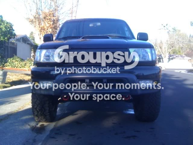

put on the clear turn signals
IMG_1178-1.jpg~original
Nice work so far. Just curious why you didn't swap the rear bumper trim over to the new one? Would have been one less thing you needed to paint. Also, what paint did you use for your fender flares?
Thanks! I was going to swap the new bumper trim over, but on the old one, I broke a few tabs pulling it off and after finding out how easy it is to pull it off now, I figured I'd just leave it and hope that will make the old 4Runner sell faster. Only took a couple hours to get it off/clean it/paint it.
For the fender flares, I used satin black krylon fusion. I think I did 3 coats and 2 coats of satin clear.
I just used the regular spray paint cans it came in and sat them in a cup of warm water for 5 minutes before I used em to heat up the paint a bit

Here is what the 3rd brake light ended up looking like after tinting it, before I put the spoiler back on
IMG_1210.jpg~original
IMG_1209.jpg~original

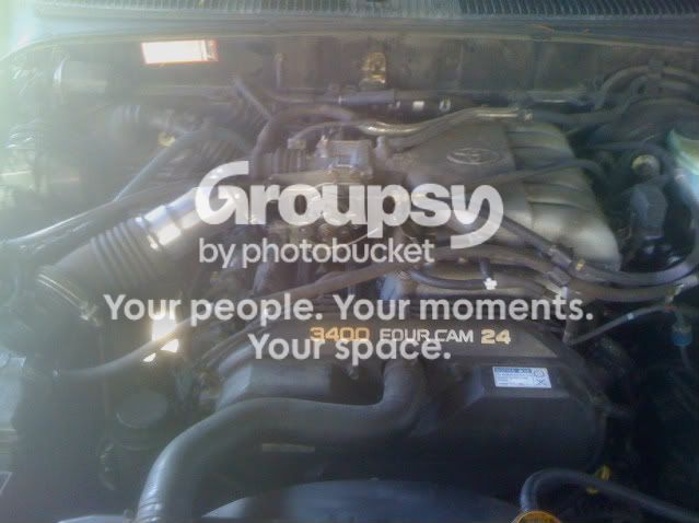

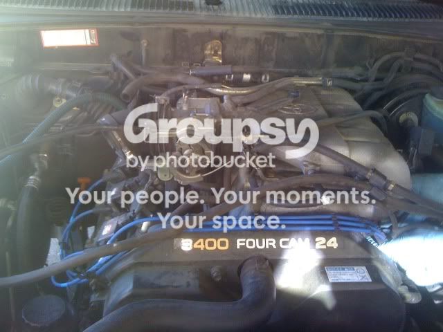

New spark plugs/wires
IMG_1214.jpg~original

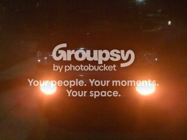

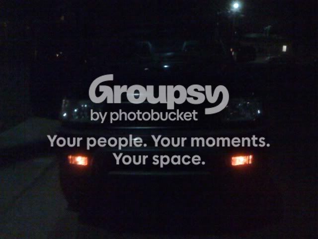

And since I added the clear turn signals, I needed to make it still blink amber and LEDs didn't work. I guess I need a relay? Instead I painted my stock bulbs "pumpkin orange"...walmart didn't have amber. It's bright as hell and looks kinda cool. Didn't expect it to be so damn orange!
IMG_1223.jpg~original
IMG_1225.jpg~original

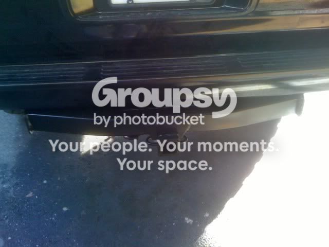

Painted my tow hitch
IMG_1236.jpg~original

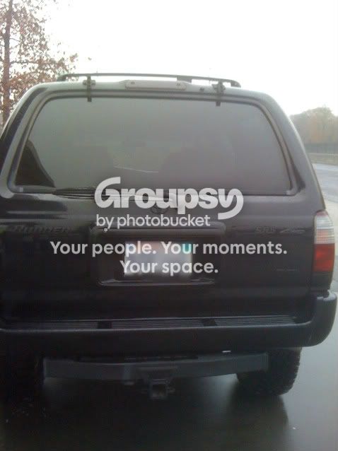

And I wanted to feel cool again so I took a pic next to a stock runner parked by me at work

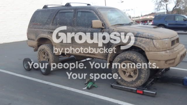

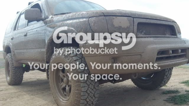

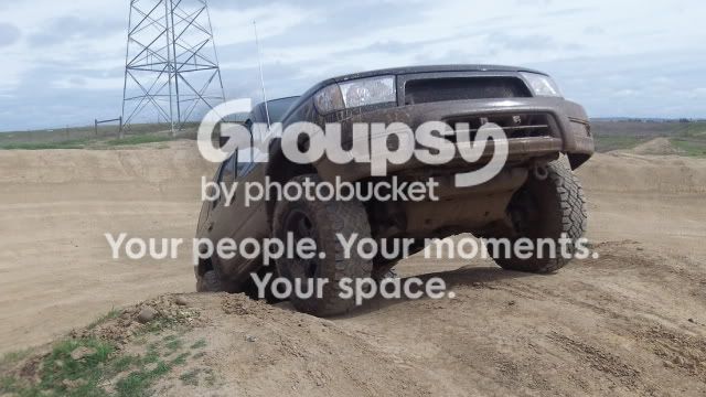

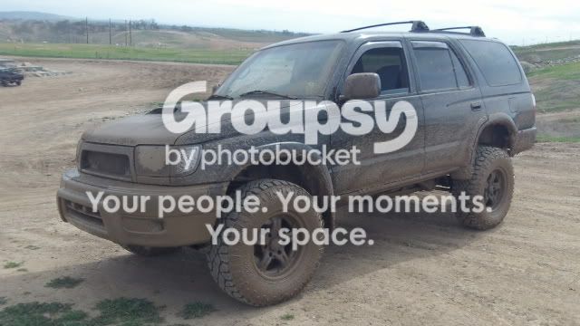

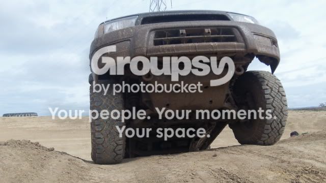

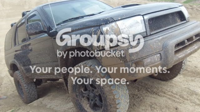

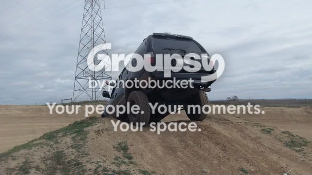

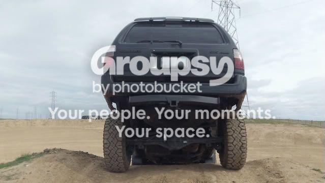

Ok, went offroad and through mud for the first time in THIS 4Runner and used 4WD for the 1st time. It was awesome. Visited my Grandpa for his 82nd birthday past Sacramento. I saw Prairie city offroad place and HAD to stop by. Soooooo much fun, and the 4Runner made it up everything I tried a lot easier than expected. Using the 4WD is like night and day. I went through this mud puddle back and forth about 5 times. Drove around a little more and stopped to take a few pics and shut the motor off. I went back in after taking pics, and it wouldn't start! Just a click. Called T4R4life and he was trying to help me and explain things to check but still couldn't get it started. I ended up getting pulled by this sick 1st gen and got to a wash area and sprayed all the mud out of the engine bay. It was 1-2 inches cakeed on EVERYWHERE. Some guys there were trying to help me get it started by wacking at the starter but it wasnt happening. We ended up getting towed to the nearest toyota dealer. Had to leave it there over night and left a note. They diagnosed it the next day and found it being the starter needed replacing. They wanted $700 total, wtf! So I bought a starter for autozone for $90 and brought it up there. My brother, Dad, and I were gonna replace it in the parking lot but toyota wouldn't let us, and it was raining and we didn't want to pay for towing, so toyota installed it for me for $250 and waived the $125 diagnosis charge. Not horrible, but could have definitely been better. Lost my wallet up there, missed work and was stuck just waiting for 6 hours too. It was a crazy day, but could have definitely been worse. Glad to have the 4Runner back and no worries. Here's some pics:
