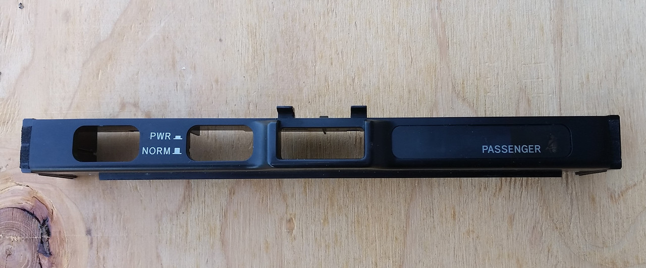

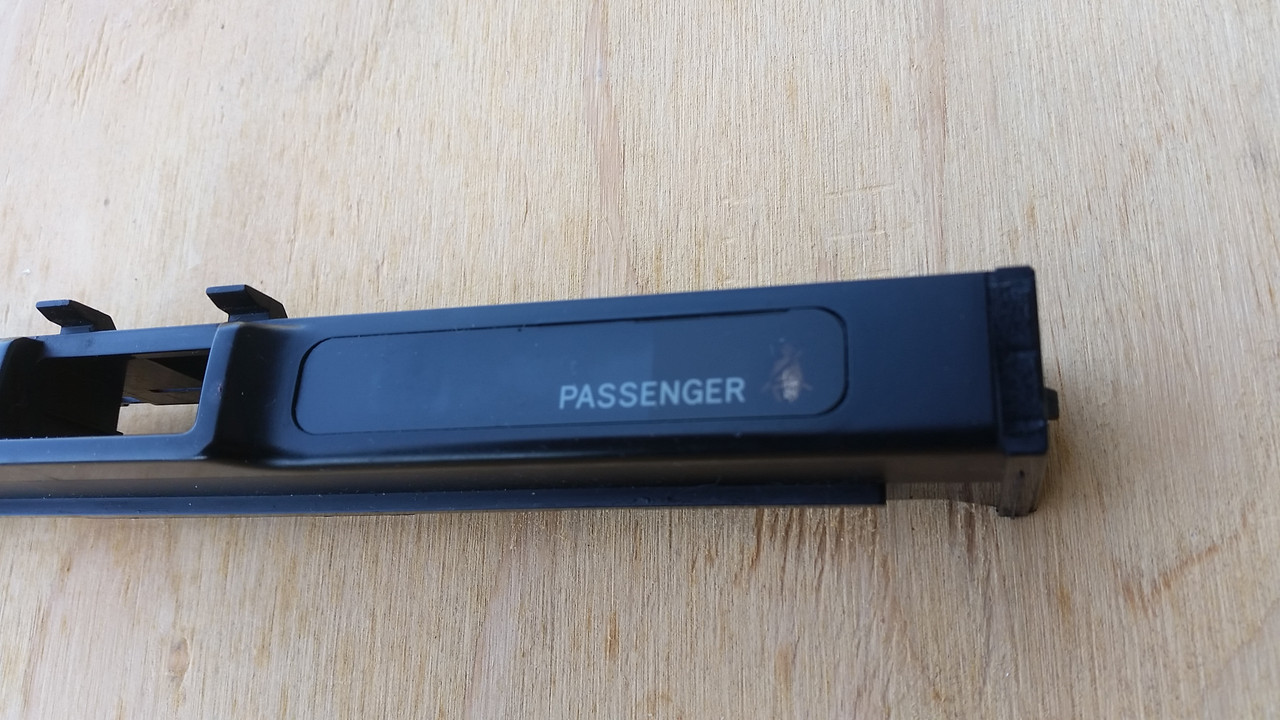

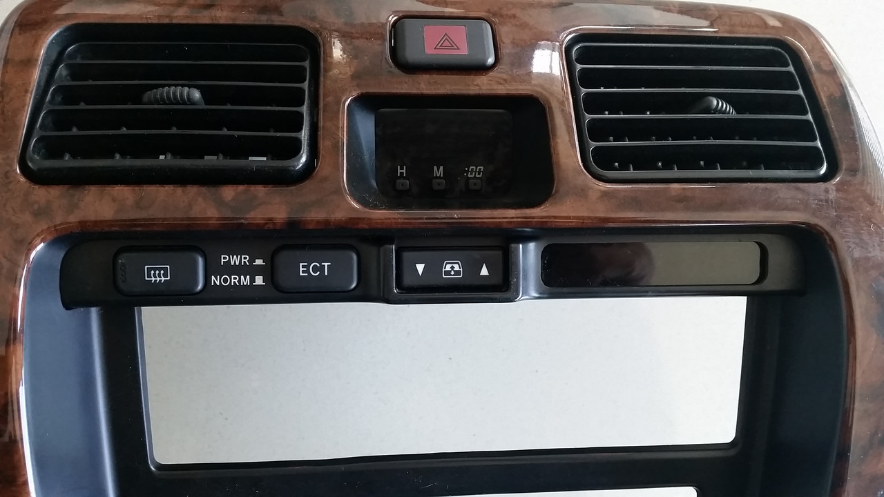

One of the things I miss in our 4Runner is having an outside (ambient) temperature gauge, something that I’ve come to rely on in our other cars. So the more I stared at the useless “Passenger” area of the center dash switch panel (below), the more it called for me to upgrade it with a digital thermometer. And while at it, why not add a digital voltmeter as well.

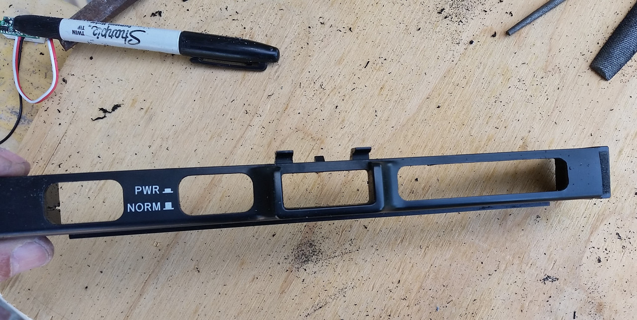

I started out by dremeling out the whole rectangular “Passenger” portion. Fortunately there is a slight groove all around it, so that was my guideline for the dremel. The groove is good at helping hide mistakes (within reason!). I also ground away all the plastic webbing behind the “Passenger” portion of the panel.

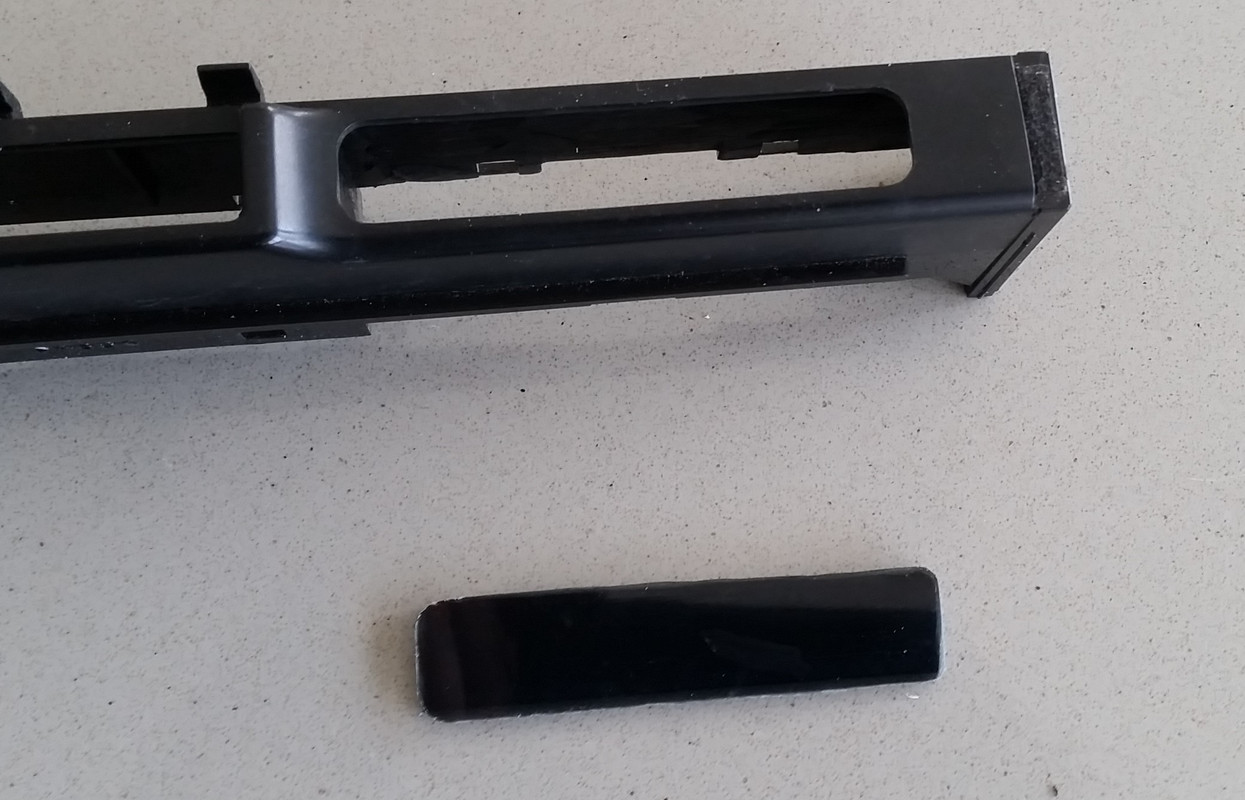

Here is the section removed and filed smooth. I used some fine sandpaper to bring the plastic edge to a finished appearance:

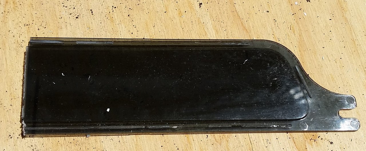

I made a smoked window for the gauges out of a center cluster panel from a 2001 Lexus GS430 – it’s smoked and flat, and I found one at a junkyard. You can find one in most any other car these days, I just picked that one because I have this model Lexus and saw that it would be the perfect donor. I cut it in half to give me a spare in case I screwed up; here is the half I started with:
I used a sander to shape the plastic piece to be just slightly larger than the opening I made in the center switch panel:
It looks way too small in the photo, but it’s an optical illusion. I then hot-melt-glued the smoked plastic to the panel:

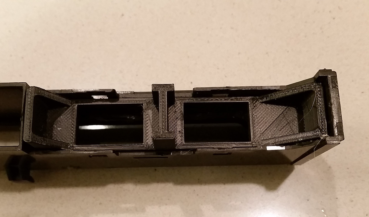

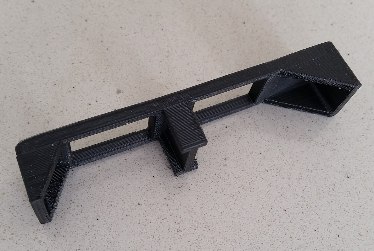

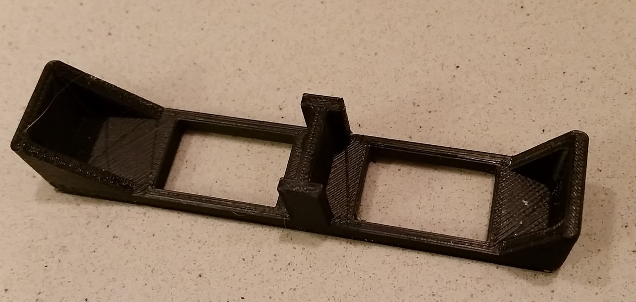

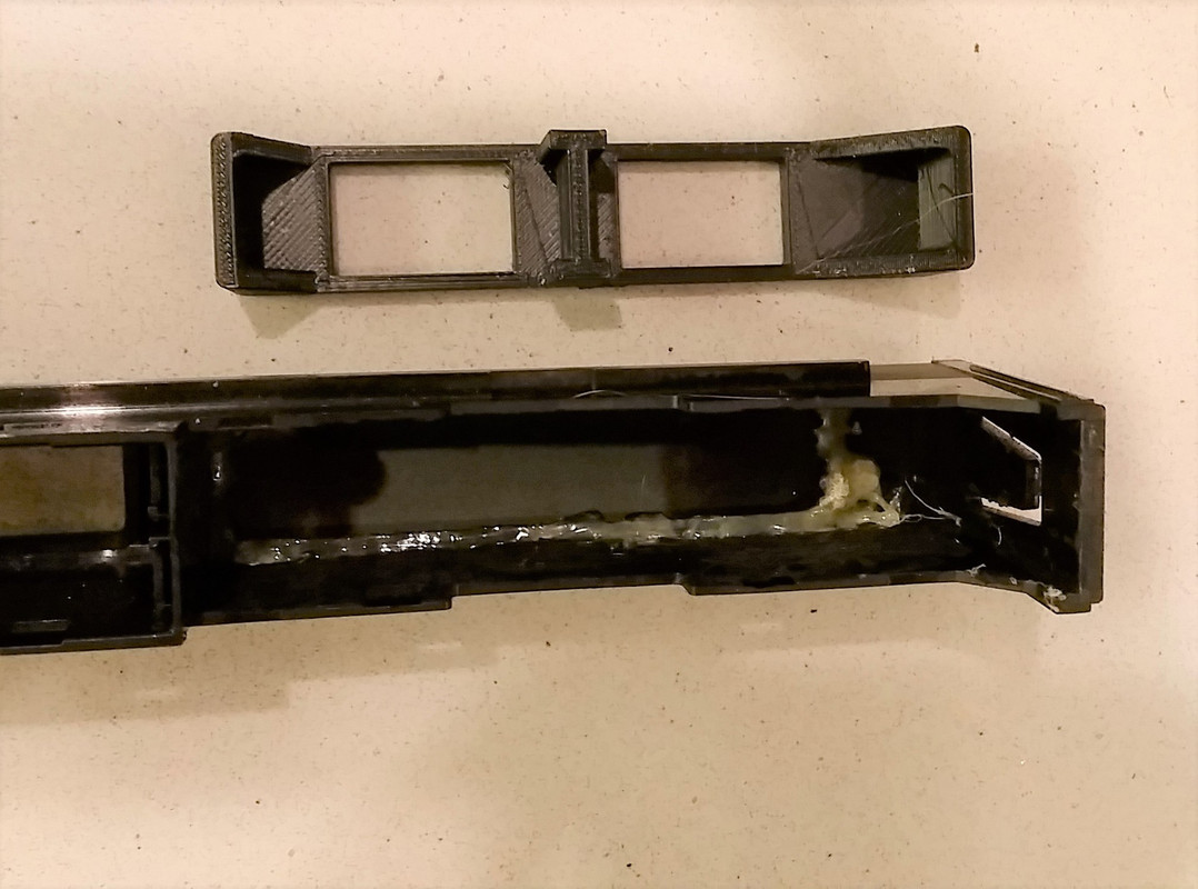

I needed some type of a holder for the actual gauges, so I went with a 3D printed solution to build a frame that would fit tightly inside the panel, and would hold the gauges well. You can use whatever you have handy to make a similar mount.
Frame installed in the switch panel:

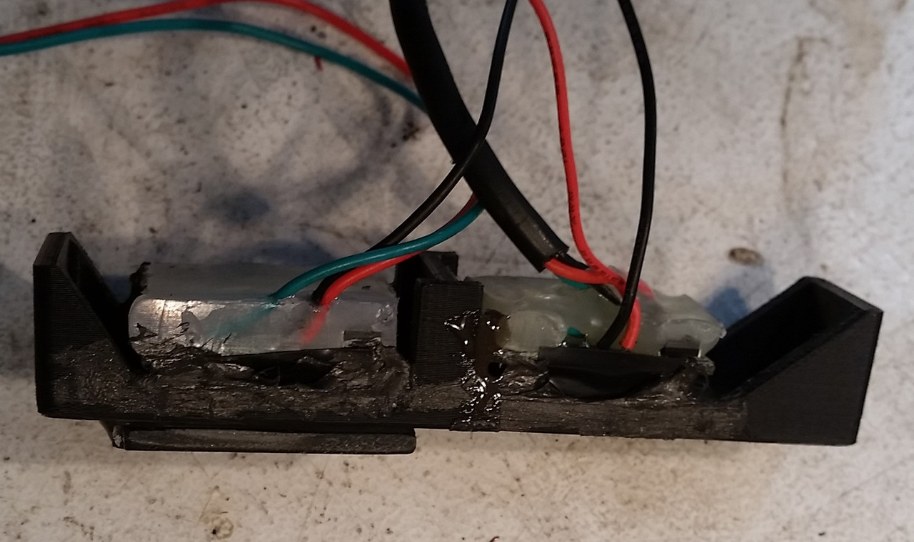

Here are the gauges installed in the frame:

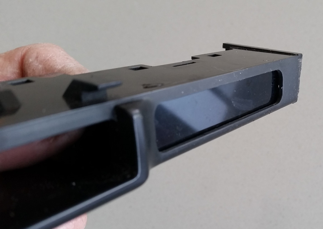

When I had them both on, the color match was good, but the voltmeter was way brighter than the thermometer. So I made a second smoked plastic piece, to place over the voltmeter:
Using window film might have been an easier option, but I didn’t have any film and I had the smoked plastic on hand.
After inserting the gauges into the frame, and the frame into the switch panel, I used some epoxy to stake everything together.

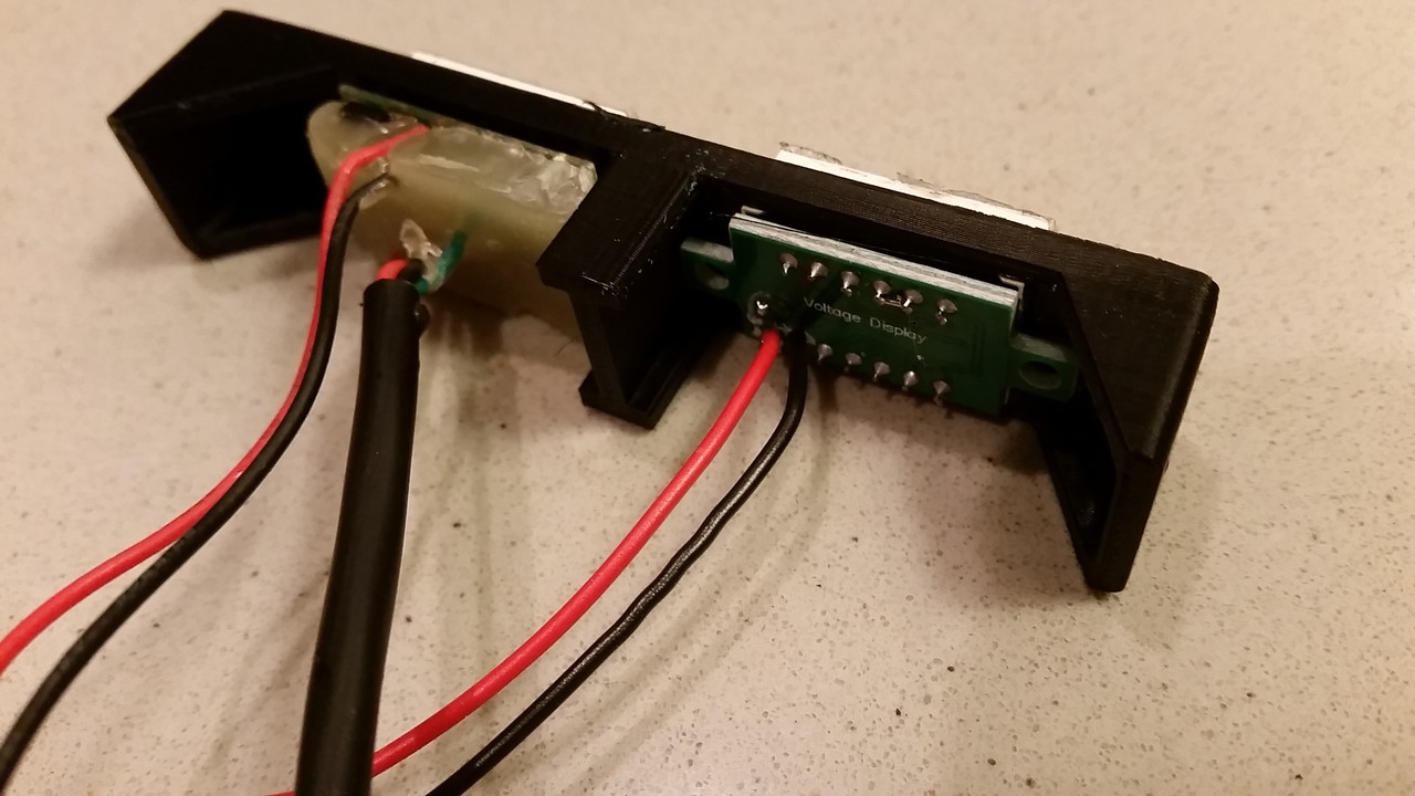

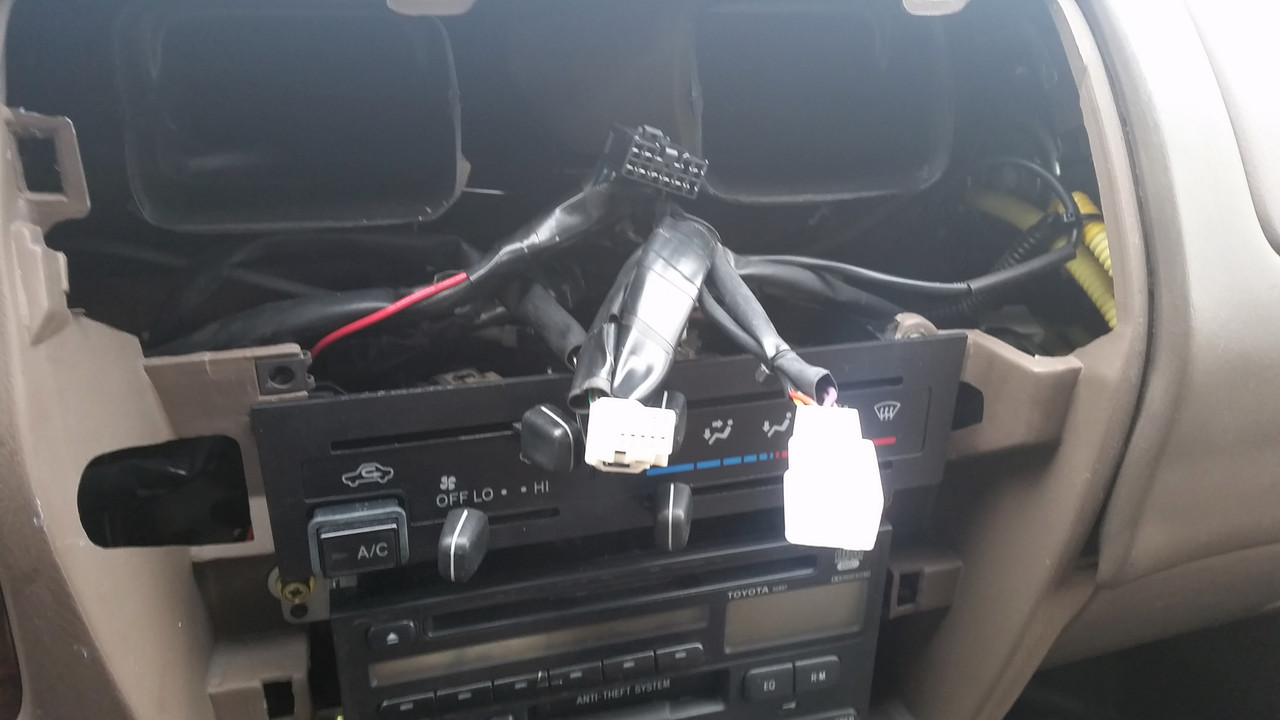

I tied all the wires together into a connector (five terminals), to make any future dash bezel removals easier:
On the vehicle side, I tapped into a switched 12V source, and a ground (both from the power outlet wiring behind the dash). I also routed the sensor probe wires to the dash bezel area. I used a 3 meter temperature probe harness, and placed the probe behind the front bumper. Here is the probe I bought:
https://smile.amazon.com/gp/product/B00KLZQ0P8/ref=oh_aui_detailpage_o01_s00?ie=UTF8&psc=1
Here are all the vehicle-side wires assembled into a connector to match the one in the switch panel (the white thing towards the right):

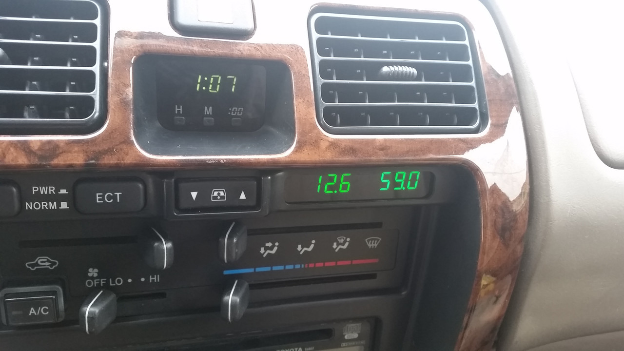

And here is the final result. Key off:
Key on:
I was surprised and pleased to see my temperature gauge agree so well with my “engine off” transmission temp gauge:
Overall I’m very pleased with the result. The only surprise so far has been that I designed and assembled everything looking straight at the dash bezel. But being on the tall side, I found that from my sitting position in the truck, the very top of the display gets cut off, so I can’t distinguish between a 1 and a 7 without moving my head down slightly. But I can live with that.
I do wish that I could find a source for good quality gauges, and not have to go through the non-working and smoking gauges. Time will tell how long these DROK gauges last, hopefully they’ll last a long time.
