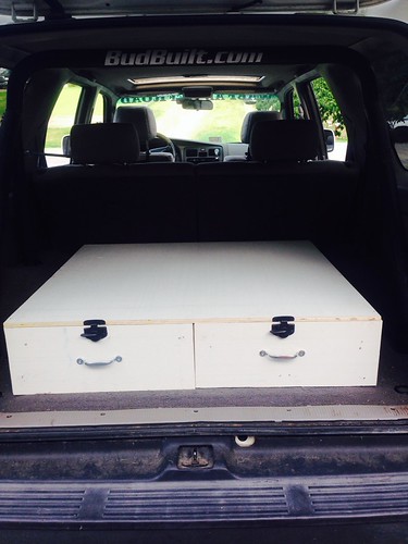

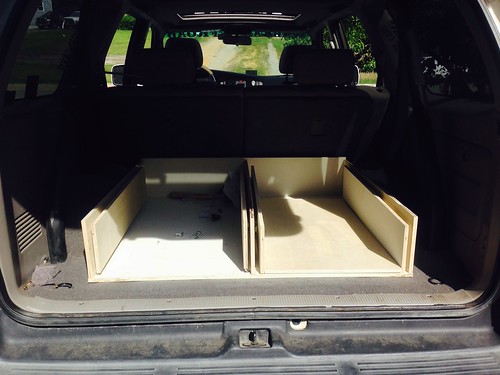

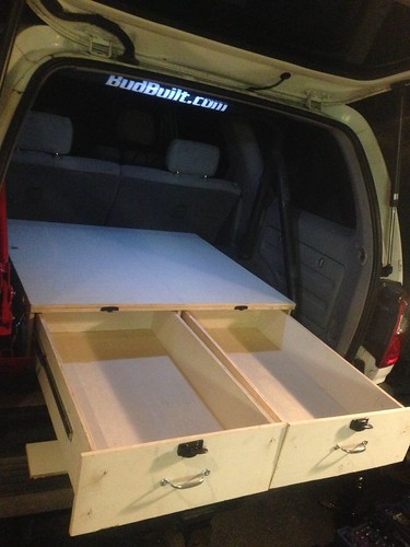

today i spent most of the day building my rear cargo box. got the idea from gottabetrd box build thread.
got 1/2 inch boards had them cut to size which for me was 36inch wide 34 deep. the total height is 8.5 inches. drawers are 30inch deep buy 16 inches. here are some pics.
Untitled by ecsbaseball, on Flickr
almost finished. just need to add some carpet and paint.

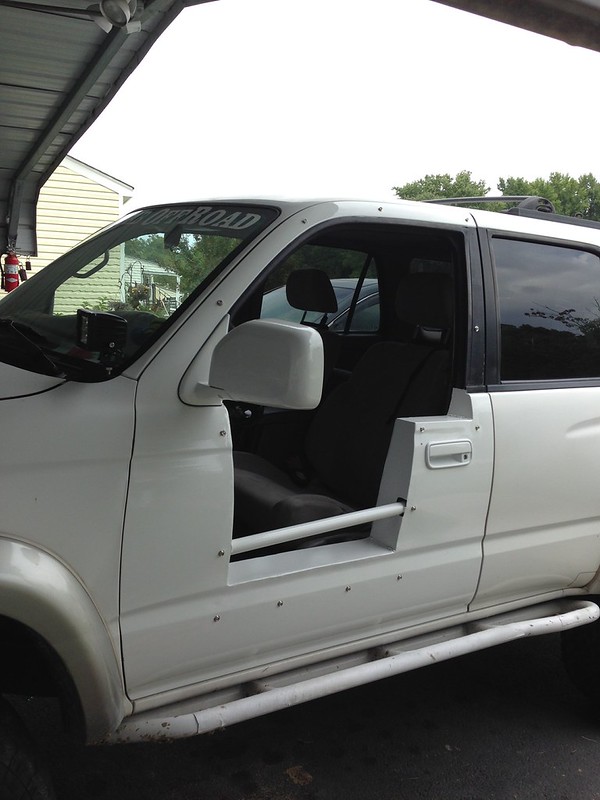

tomorrow i hope to have my doors cut for half doors.
