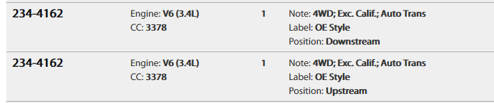

Downstream Denso sensor #234-4153 is a fairly universal part (it fits my CA emissions, manual transmission 1999 4runner).
Check out Rock Auto's drill down menu of all sensors for your year / model here.

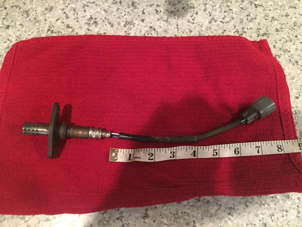

Correct... but that is the toyota # on the sensor. I called toyota, according to my vin it should be 89465-39855. That crosses to a denso 234-4154 for a man trans with 12.91 wire and doesn't look the same. Mine is auto trans with 8" wire. Seems amazon has the 39855 that looks correct....but for $120 bucks!

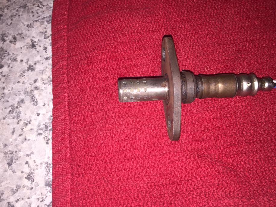

This is the sensor
Shouldn't I be looking for an identical sensor as the one pictured? wire length is not really a concern.

From my experience on my non-California emissions T4R (3.4L, LTD, 4WD) I have always purchased Denso 234-4162 (Both sensors the same) from Amazon.com. The FORE and AFT sensors are both the same part number. Amazon seems to have the best pricing and service on the Denso 02's...
There is no difference between the O2 sensors OTHER than wire length. Proof of that is that Denso sells a universal O2 sensor with a pigtail that can be wired into ANY flange type O2 sensor. The numbers stamped on the sensor NEVER match the numbers on the box or the part listing. Stop looking for a part number that does not really exist as a listing. As long as your plug matches the harness (which proves you really have a non-Cali.), any Denso O2 for a 3G 4Runner with enough wire will work. Stop obsessing and get on with it.
