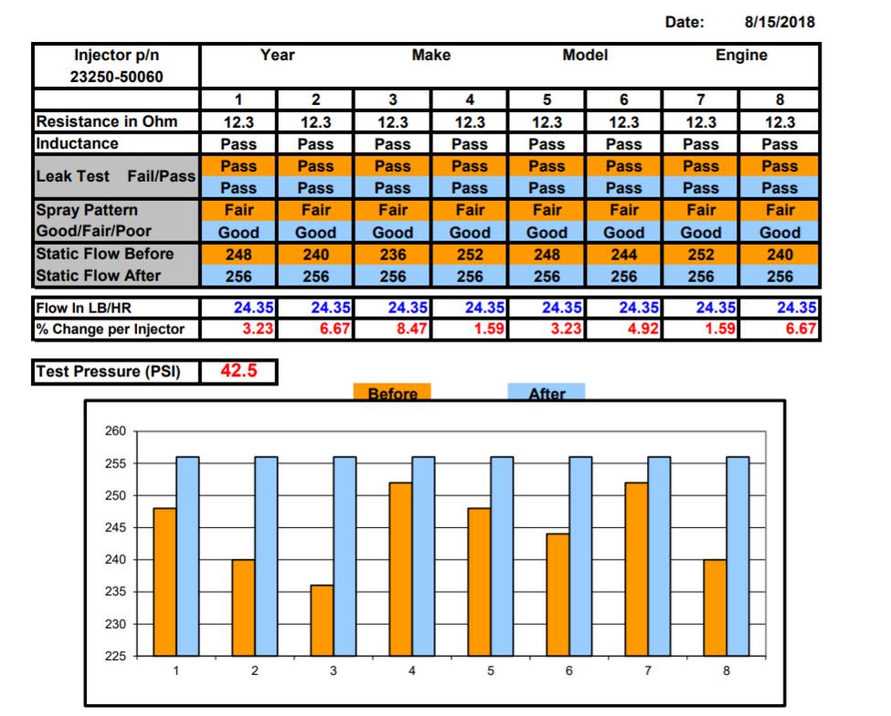

Very similar situation - my engine was also rebuild and injectors cleaned.

Attaching injector cleaning report.

that person had all the injectors professionally cleaned, rebuilt, and pressure tested from an injector specialist (not just a garage) and they all passed inspection, but there were 2 that were still dripping fuel and after buying 2 new injectors there were no more problems
