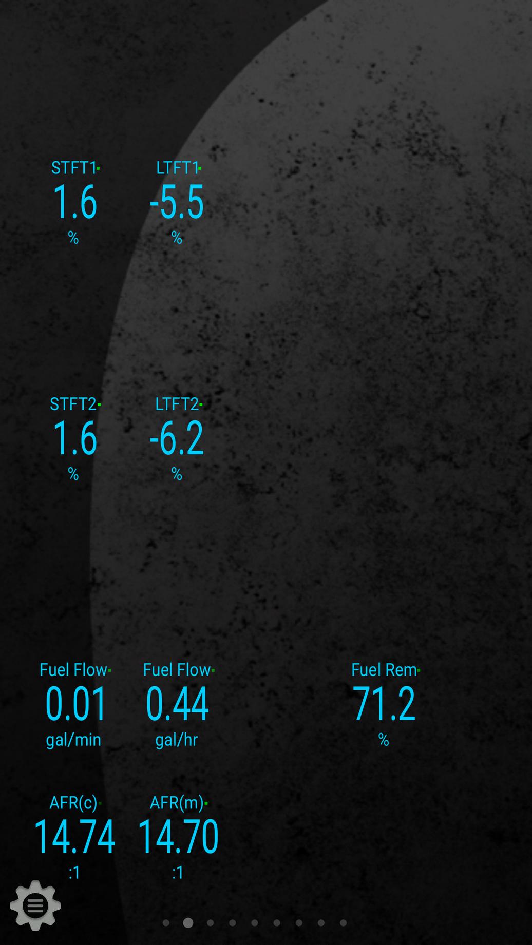

My long term fuel trim is at -5.5 and -6.2. Also, my commanded air/fuel ratio doesn't quite match the actual.
The long cranking time and this data suggest the engine isn't fully happy. The LTFT data likely point to either incomplete combustion due to spark plug problem, or excess injector flow on one or more cylinders on each bank.

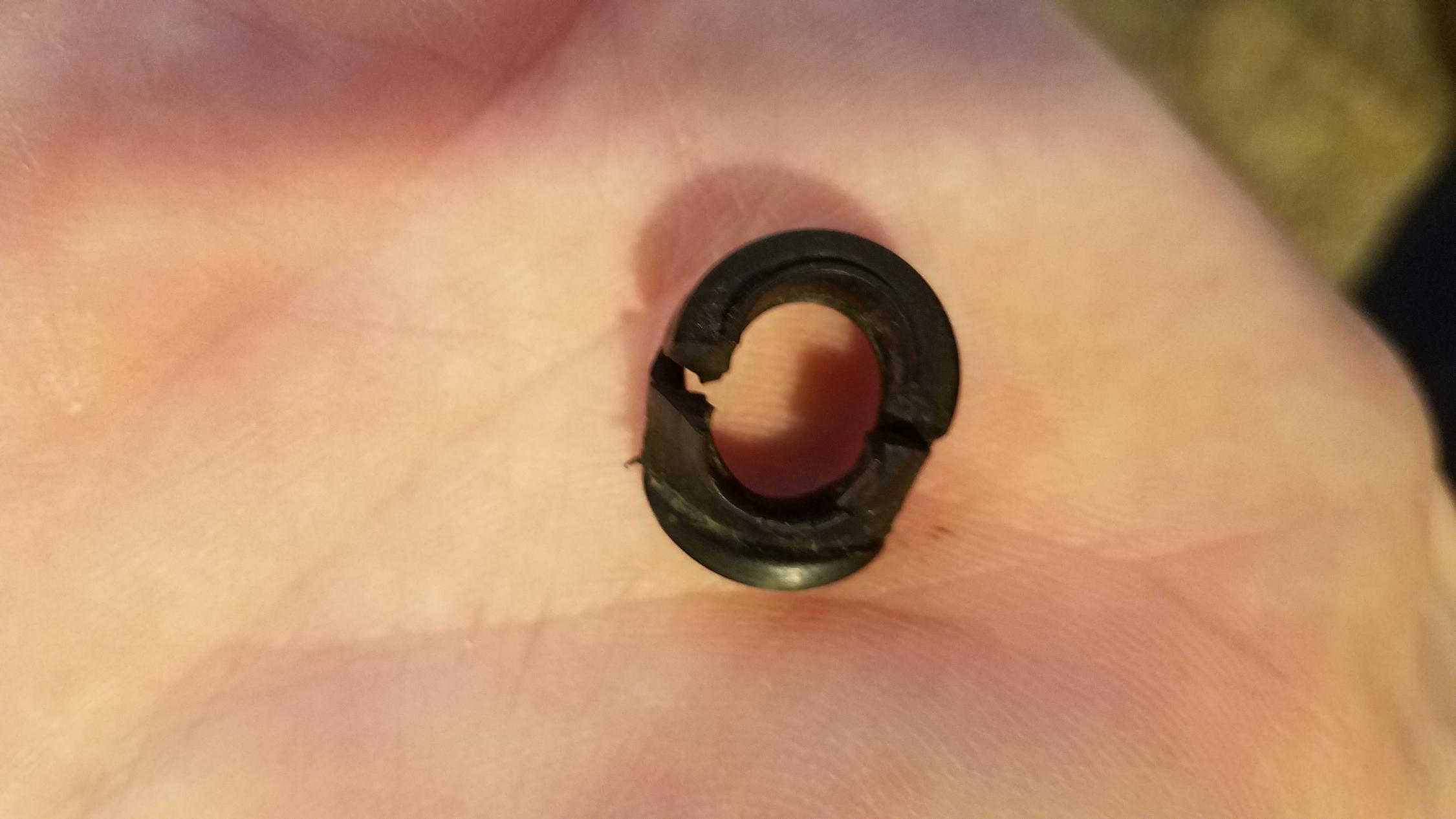

I replaced all 8 injectors last night, and it seems to have fixed my problem! The injectors that I purchased were branded as Standard Motor Products on Rock Auto, but they turned out to be stamped as Denso, which is OEM. I'm glad I got those... saved myself $400 bucks. Everything matched the old injectors, and it was a super easy install.
After removing the injectors, I noticed that the injector seal/bushing on cylinder 7 was cracked, and installed incorrectly long ago, so it didn't have a complete seal. I only had the injectors, and not the seal kit (which I regret) and had to run to the part store to get a new seal. I got a new seal, and re-used my other 7 and everything went back just how it was supposed to.
that broken seal was most likely causing some of the codes, it would be a big intake leak messing with fuel air mix on that cylinder.
cant believe you only replaced the one seal, that is shade tree mechanic work. if one seal is bad then the others were needing to replaced as well, so you made a mistake there, hopefully that decision to take a short cut wont come back to haunt you
If needs be I can go back and replace the others later. The other 7 actually looked really good, so i'm not too worried. The one that is cracked was installed crooked, so it failed prematurely. Hopefully it just doesn't give me any more problems :)
