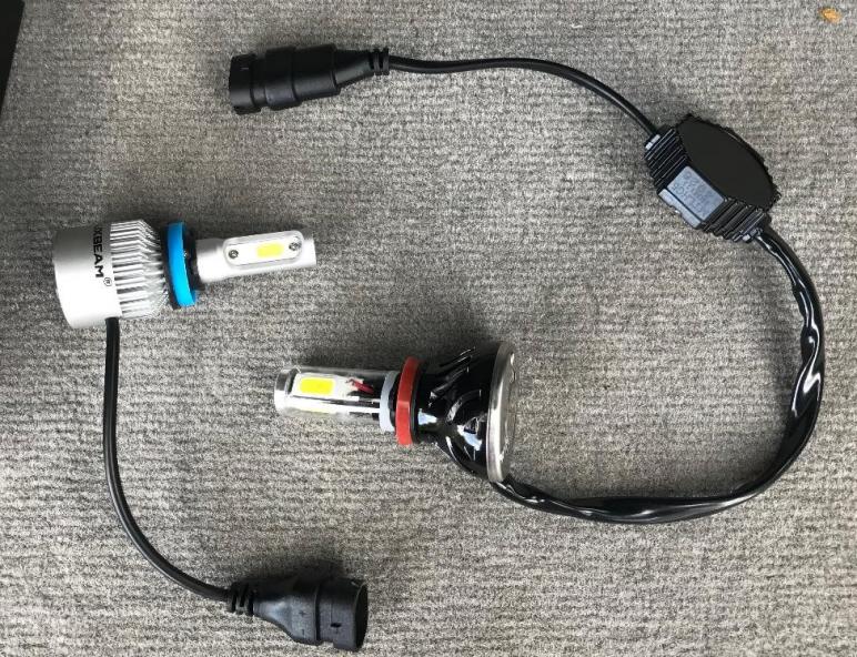

Just got the XenonPros LED high and lows in. I will see tonight how they perform. First impressions, the fans are massive but also pretty quiet. The gaskets are excellent and made great seals on every bulb. They have leds in all directions. Not just left/right or top/bottom. The plugs is indexed so that you can reverse polarity and still have a locking tab click in (didn't have to turn any of them though). They seem very bright but I will really see tonight.

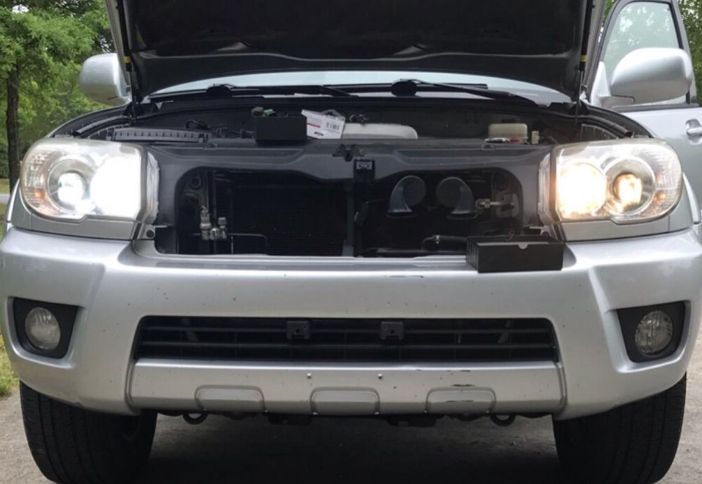

I promised a review on the Auxbeam vs Xenon pro so here goes...
For lows I am now using the Auxbeams and I am really impressed and happy with them. Although the XenonPro bulbs are "brighter", they don't have good projection characteristics and really suffer when put into a projector housing.
For the highs I kept the XenonPros because they really ~shine~ bright here (lol). Obviously with them being in the reflector housing side of the headlight it is much too bright to drive with them while other are on the road ahead of you. But it you need something stupid bright while traveling dark country roads at night (like I do quite often), then these are the highs for you.
Since I bought the Auxbeam highs and am not using them because they don't even hold a chance against the XenonPro highs as I have now found, I was unsure with what to do with them...But I ended up putting them into my fog light housings and they do great there.
All the color profiles are pretty much identical to me.
I also included some pictures of the low beam bulbs side by side. The quality seems solid either way. You can't really see from the pic, but the XenonPros have 4 sides of LEDs whereas the Auxbeam only use 2. Hence the XenonPros doing better in the reflector yet not in the projector.
I also finished up the mod for allowing all lights to be on at once. Highs, lows, and fogs. And WOW is all I have to say about that lol...
