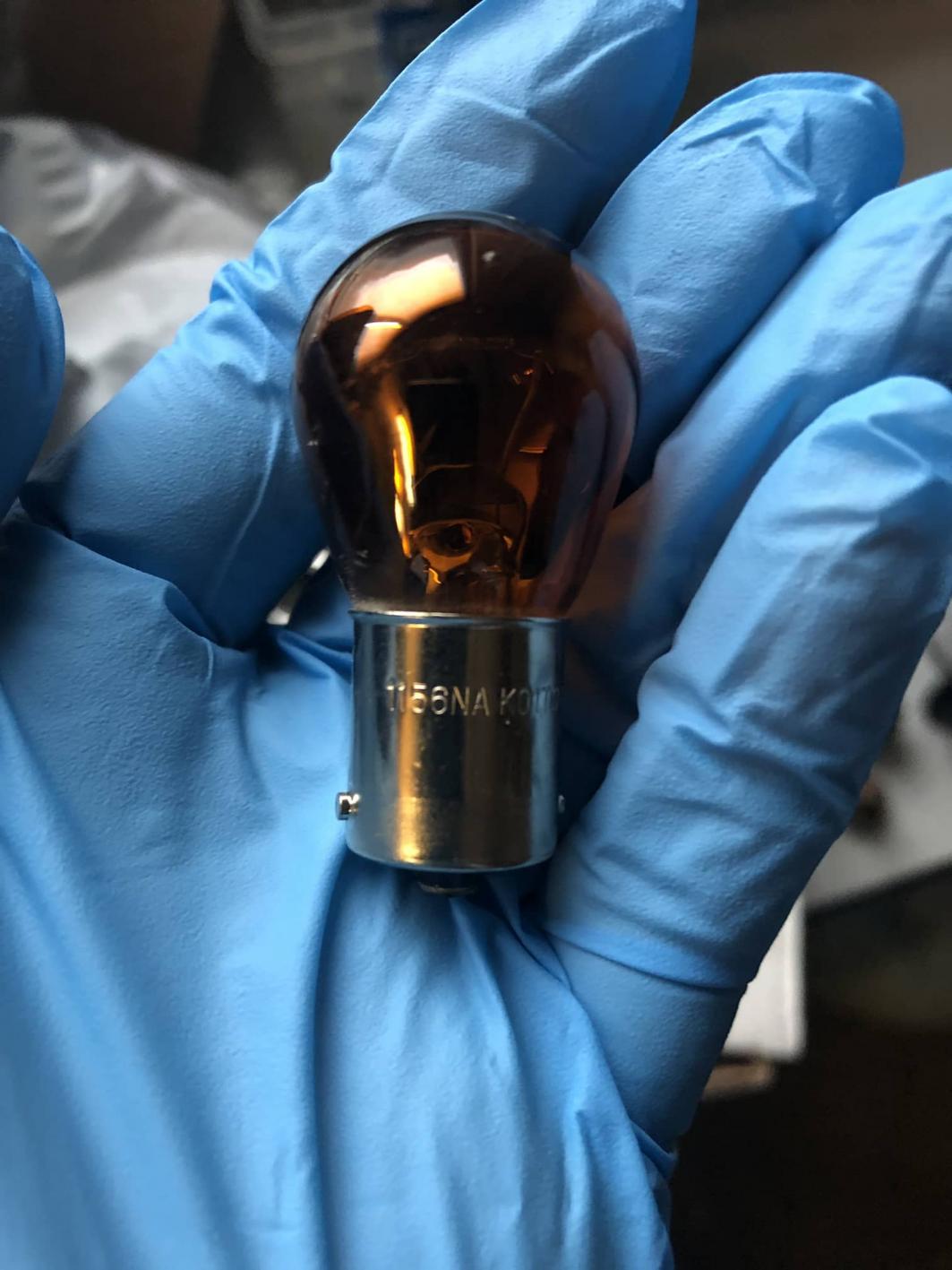

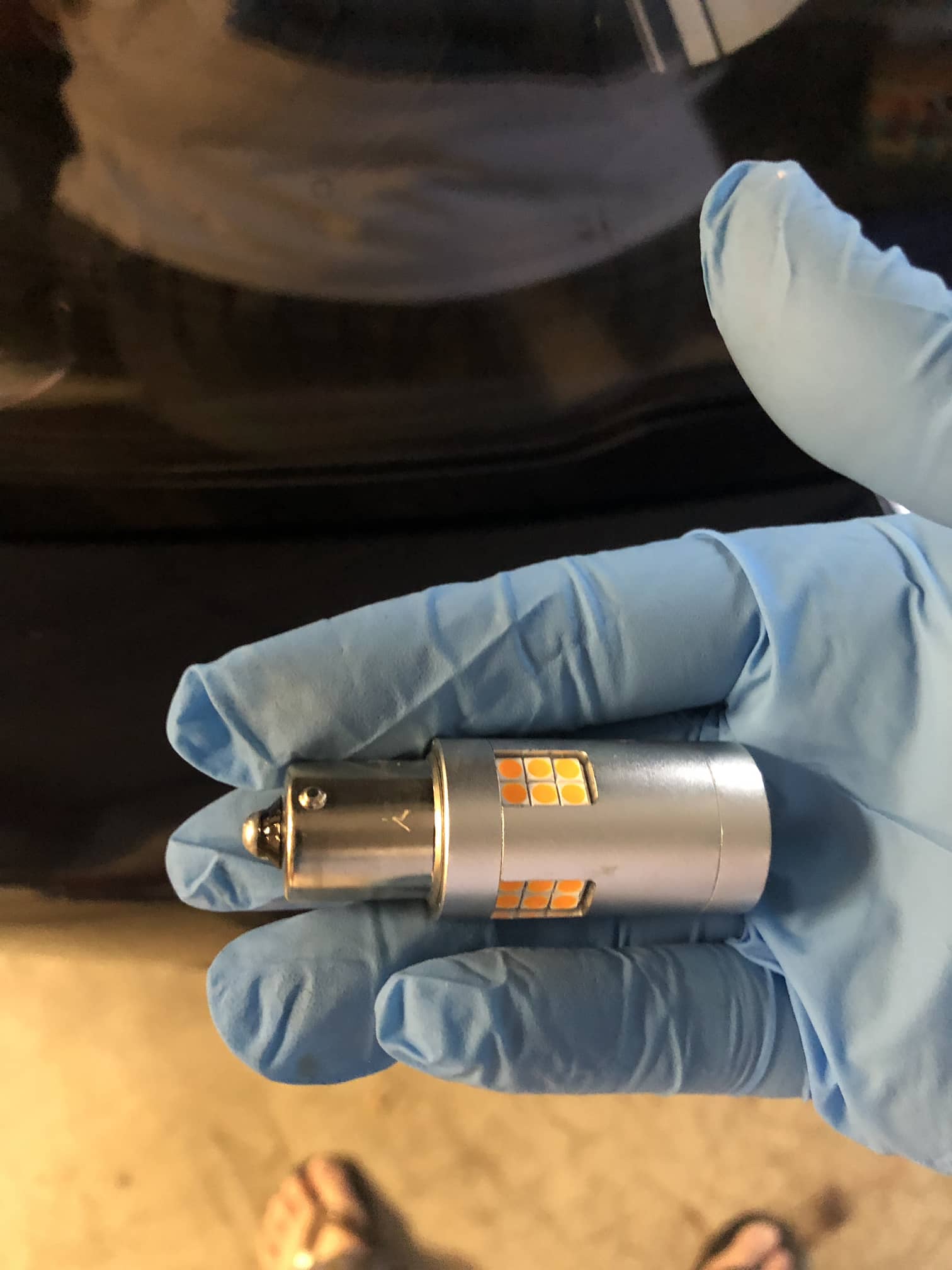

Thanks to [MENTION=74494]Az4runnin[/MENTION] for pointing out the 1156 DRL’s are out of stock. Please contact the amazon seller prior to ordering the Vehicode DRL’s.
OEM DRL bulb pic and correct DRL LED pic below. Note the base.

When I ordered mine, I got the 3156 version which has the flat, blade style base since my DRLs used to be in the bumper on my ‘04. When converted to the projector style lights, they were brought up to the headlight housings. I wonder why Toyota would go back to those old style bulb bases on the later models? If you ever happen to take them out again for some reason, can you take a pic of the socket from the side, and front (where the bulb goes) please?

The Vehicode seller had the 1156 bulb in the pull down menu. Instead of leaving that item in the menu, when he ran out of stock he pulled it completely. The 06-09 socket receives the rounded bulb base. There is no way for it to receive the flat base.
