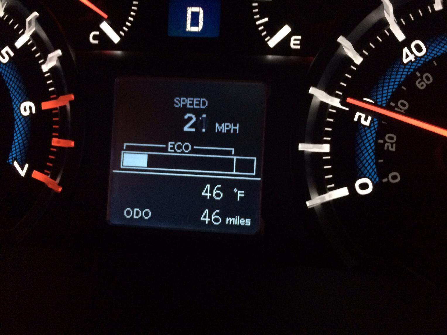

I turned the green eco light off pretty easily... What im talking about is the eco gauge in the message center in center of dash. It has a few different display modes with one of them showing your speed. Problem is that if you choose the mode that displays speed it also has an eco gauge that shows real time eco status. Im trying to figure out if i can just have speed displayed in the message center. I will try to post a pic of what im talking about. Thanks for the help
This is an image of what it looks like

In the message center go to settings, scroll down to eco light, select off. Only turns off green eco light.... Annoying eco bar still there tho
on the MFD, the only way your going to get rid of the eco bar is to reprogram that display setting within the ecu for that display to remove it.
now if it was a true user modifiable display like some of the new lcd gauge clusters, I could see you removing that option, but since the 4runner is not that type of display I don't see how.

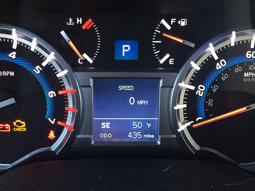

I was able to completely disable the eco gauge (not green eco light) with a toyota techstream. The setting is under the other custom settings, cant remember exactly where.
