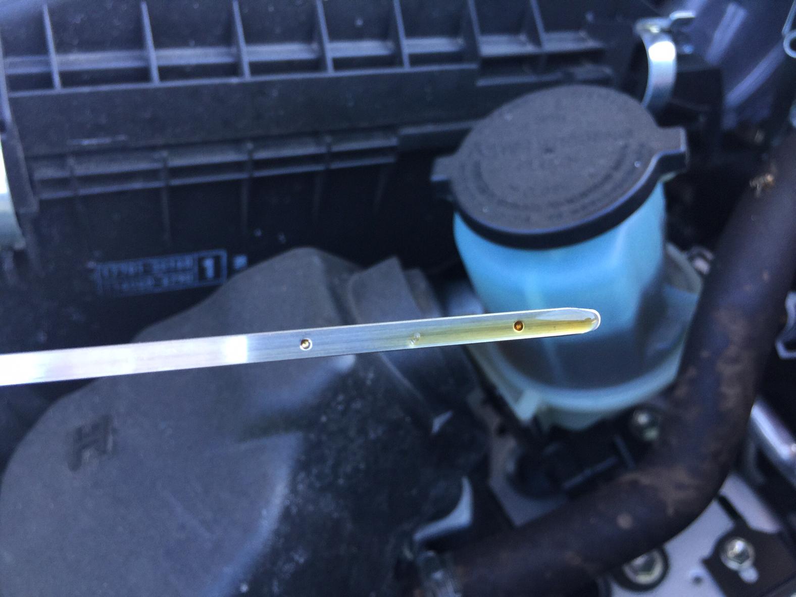

The dealer said that The Trail has skid plates which would catch leaking oil and keep it off the pavement. I checked my oil level after about 100 miles and it reads between the marks which I think is normal. Hopefully nothing more comes from this. Nobody has posted any big issues with the new engine such as a failed main seal. This one may go down as one of those mysterious dealer stories. In the meantime I keep a watchful eye on it and will do what they say and bring it back. I'm not that worried about it since I have 20k left on the warranty
Oil Level
After dealer oil change and 100 miles the level is between the marks
